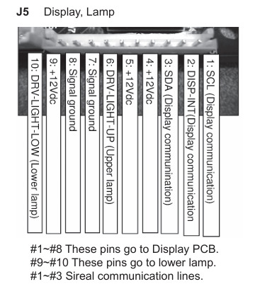

The wiring diagram is available for model JUD248CWRS01, and is attached. Here are images showing the connection layouts between the main control and the display. The image includes:
The J5 connector on the main control
The J1 and J2 connectors for the display
The overall connector layout and orientation
One thing definitely worth checking is the wire harness along the door track area. Those wires can flex repeatedly over time and occasionally break internally or develop intermittent connections, which can cause display and communication issues.
