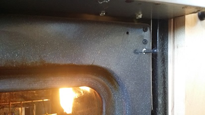

I attached two pictures of the front of my oven with the door open. It looks like the whole faceplate that surrounds the oven needs to come off. I started removing the screws by the pole that controls the light, and the light did go out when things got loosened, but I couldn’t get that whole plate off. The first picture shows where the pole is in the upper right corner, and the second picture shows screws that connect from the side that aren’t accessible. I’m not sure how to get in there…
Carol, that looks just like mine. I pulled out my stove and took off the right side panel and the switch was right there, all I had to do was tighten up the two screws that holds the switch in place. I also tried to take off the front panel first, the side panel was a piece of cake to take off and put back on. Once you get it off you will see the problem, it is pretty obvious. Good luck, Camelion :slight_smile:
