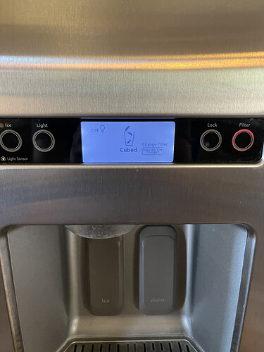

What happens & when: When dispensing ice the display dims about 50% for a few seconds, then brightens when the ice door is fully open. The display dims again when the ice door closes. If the water dispenser is running when the ice door closes, it will shut itself off and the oz. number on the display resets to zero. Could the ice door motor be drawing too much current?

Dim when ice door is moving:

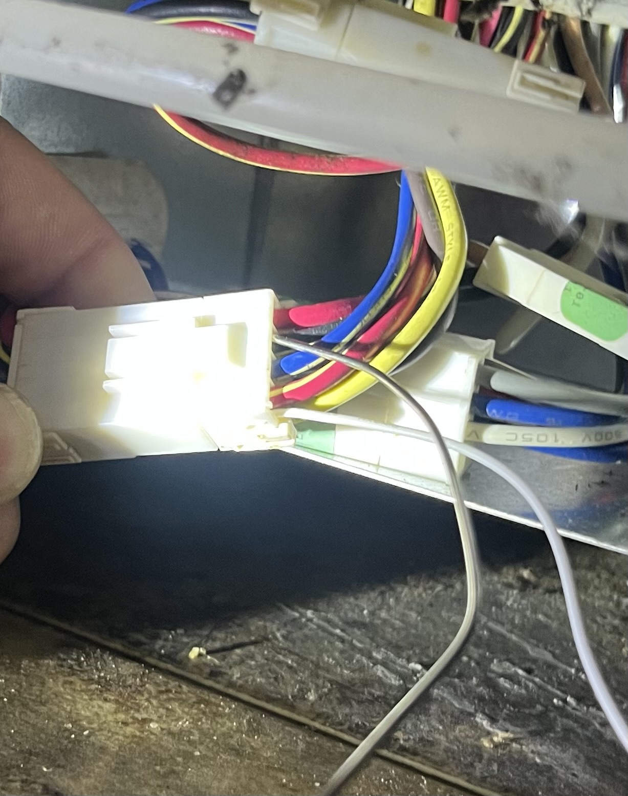

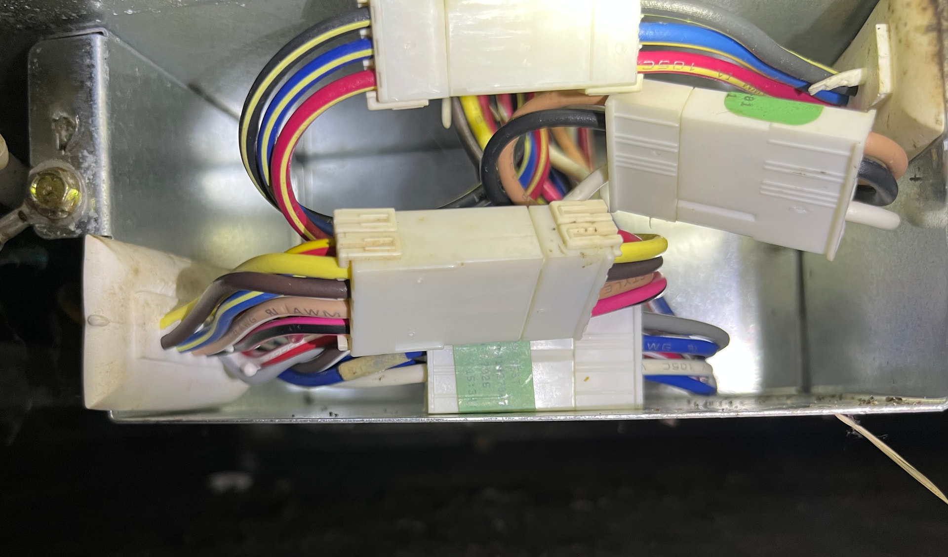

Thanks for your reply; I see several wire connectors in the box near the botom door hinge. There appear to be two connectors with red/yellow + black yellow: a 3-pin with small gauge and an 8-pin with larger gauge.
can you tell me which harness is the correct one, and how I access the contacts if the connector is plugged in?
Sorry for my ignorance.
Testing would be at the 8 pin connector. There should be enough slack to be able to rotate the right side (in the picture) towards the front. The little tabs on the sides of the connector can be gently pried away and then pulled toward the harness. This will open up the wires for testing. If a small lead is needed for the meter probes, a small section of a paper clip can be secured to each probe to act as needle leads.

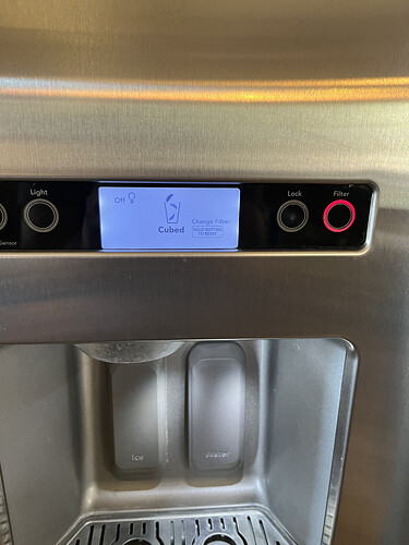

Door closed:

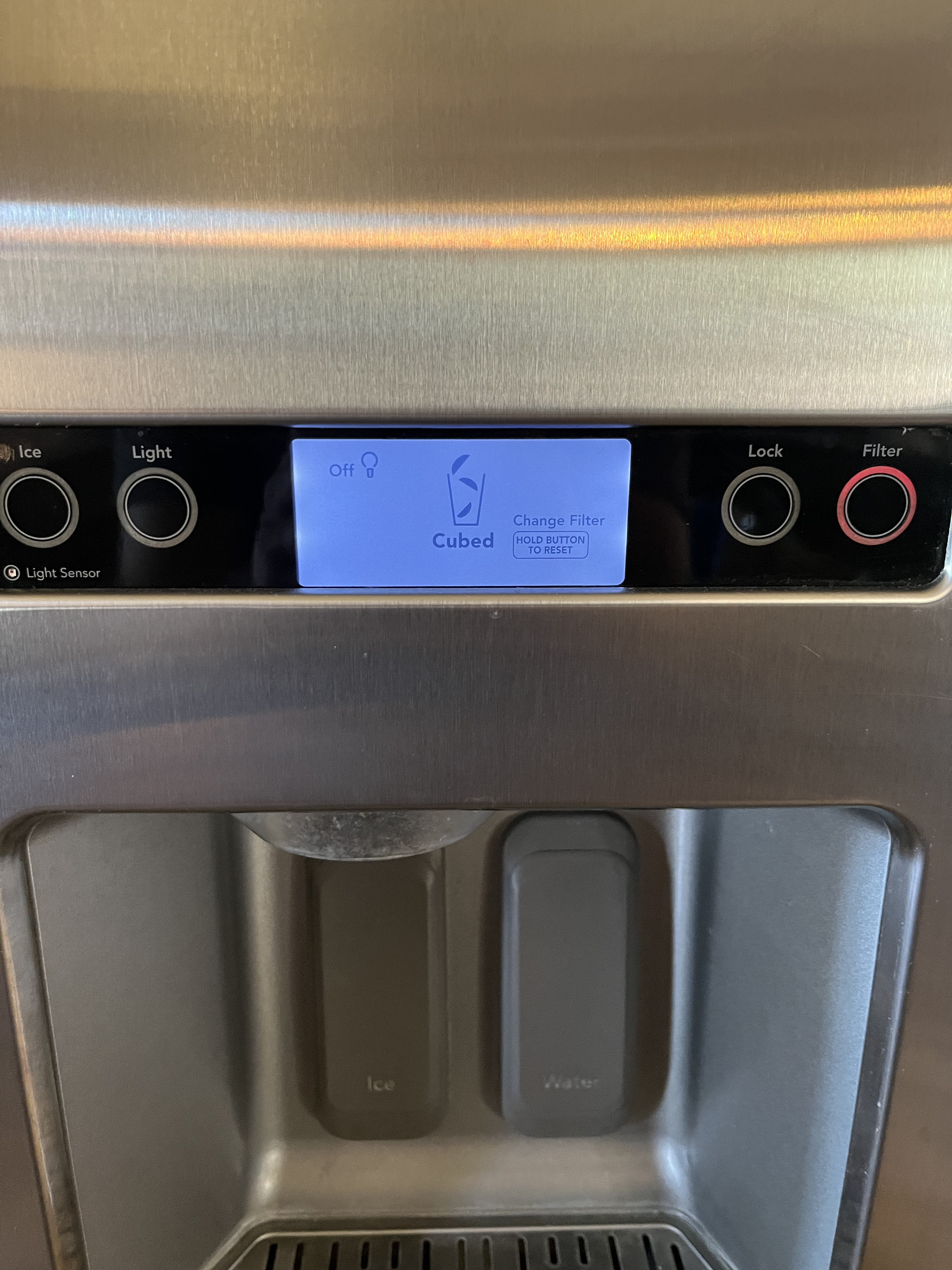

Door opening:
