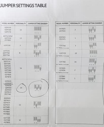

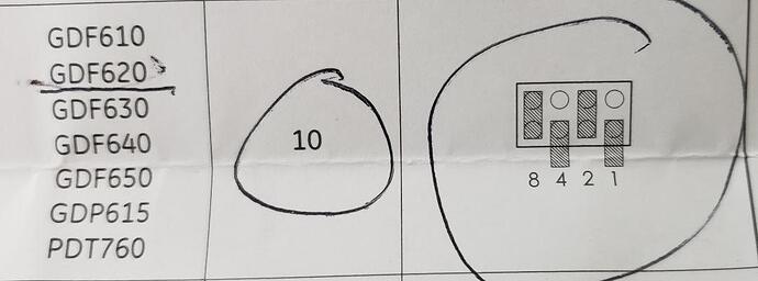

It has a solid green light only. Also, as I previously mentioned, I changed the control board as well. This is the new model board you move the jumpers that match your model # GE dishwasher. As seen in the photo below 4 and 1.
. This is the new version of it that you move the jumpers that match your model # GE dishwasher
A steady (solid) green LED on the main control board is actually a good sign—it tells us the main control has power and is working. Most of the time, when you see that solid green light, it means the main board has lost communication with the User Interface (UI) board in the door.

I’ve done the breaker swtich off a few times and no response. All the cables are fine but, I will check them again. The door closes I don’t have a multimeter so I will not be able to check. Personally, I think it’s with theses new control boards they have now. I have read a lot of problems with them. They are universal now and you have to move the jumpers to match your dishwasher
That is very true. If nothing else maybe you can get another board?
