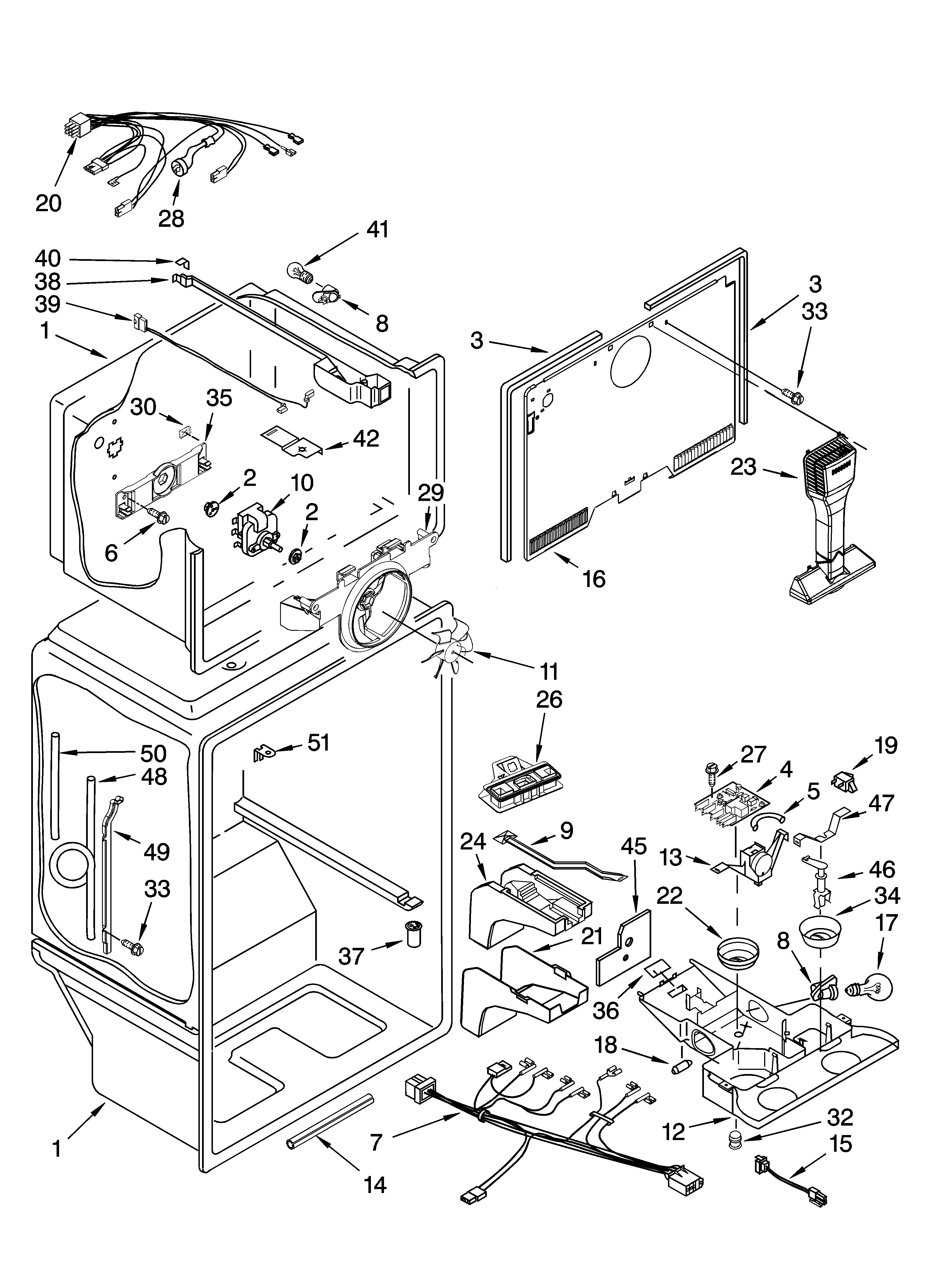

Refrigerator is not cold compressor goes on, if you put ice in the freezer it stays frozen but it won’t make ice and the frige is not cold because the fan in the freezer is not working, it’s not circulating the cold air. Need directions on how to change fan in freezer,

The model number you posted is incomplete or incorrect. Verify and repost it, please.
sorry Gene mod # is correct checked it again GR2FHTXV000.
serial # EW3118232.
Whirlpool 2 door freezer on top.
Gene it could be GR2FHTXVQ00
The last one looks as the right one.
Remove the rear panel in the freezer and you will see the fan motor (#10 on the diagram). Make sure there is no frost built up which can block the fan blade from spinning.
how do you get the back panel off and the cover on the fan i tried but I don’t want to put any preasure where i’m not supposed to.
Al
There are just a few screws to remove.
