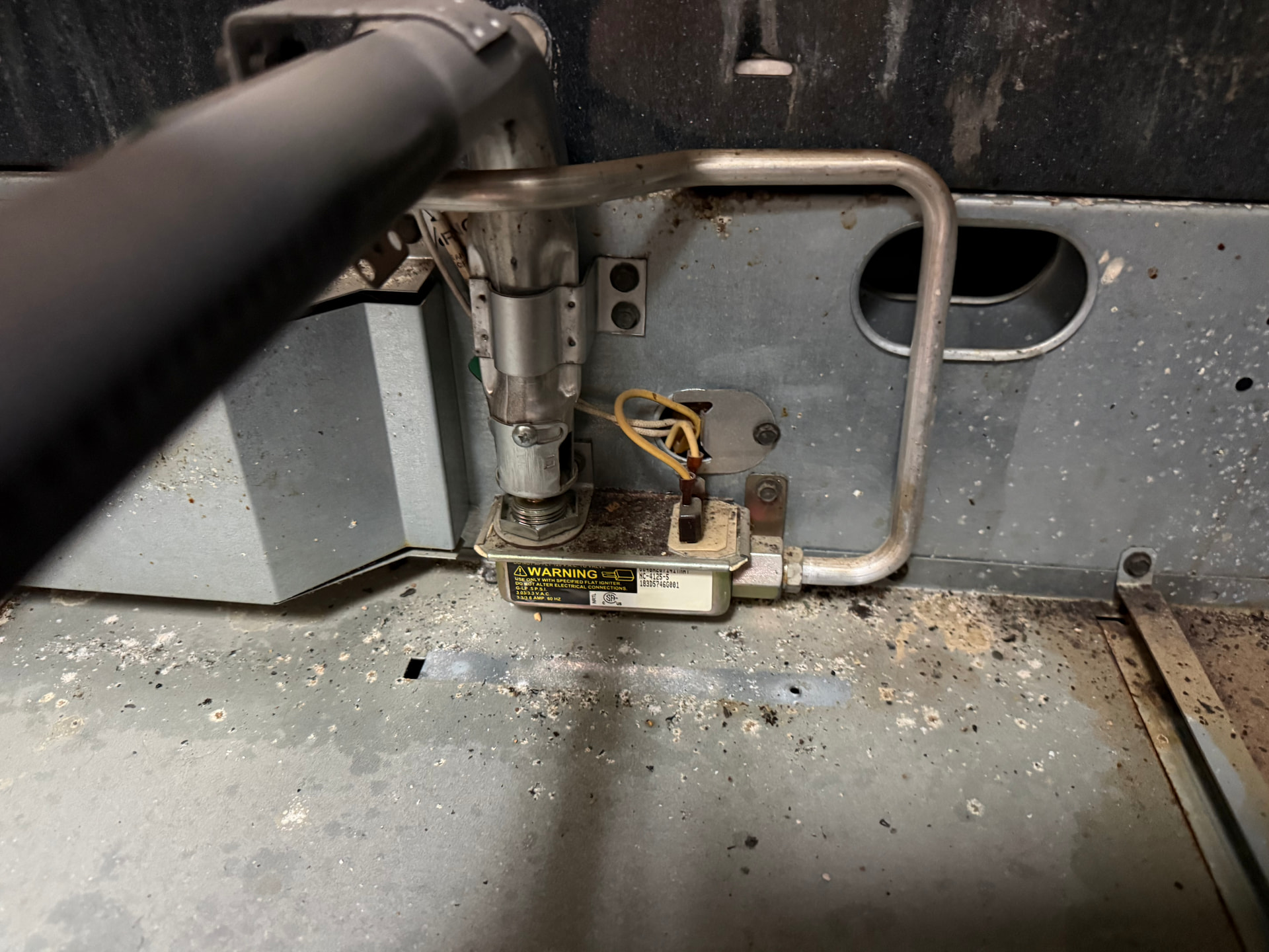

Hi, the High temp spade shield connectors crumbled when removing, what can I do to fix this? Thanks
Brand:General Electric
**Model Number:**jgbs23wea3ww
Main Symptom: exposed temp spade
Are you talking about the ones on the board, the wiring or something else?
Hi Thanks for the reply. I think it’s called the Oven Safety Valve I will add before and after pictures.
That’s just heat damage from the the oven cycling. You can replace the spade connectors with new spade connectors that are rated for high temp, sadly there is no replacement wiring harness available for your model
Jeffrey, Thanks for the quick reply, do you have any recommendations? I think Idid find something on Amazon Sherco-Auto 100 Pcs High Temperature Non-Insulated Male Spade Connectors - 16-14 Gauge Quick Disconnect .250 Tab - Wire Splice Connectors for Strong Crimps in Electrical Wire Terminals - Made in USA: Amazon.com: Industrial & Scientific
Will this work and can I use it just like it is exposed?
Once again thanks.
I would really recommend against bare exposed connections, just for safety reasons. Something along the lines of this (10 X 6mm 6.3MM HEAT RESISTANT ELECTRICAL PUSH ON SPADE TERMINAL FASTRON BLACK COVER - CaterSparesUK)
