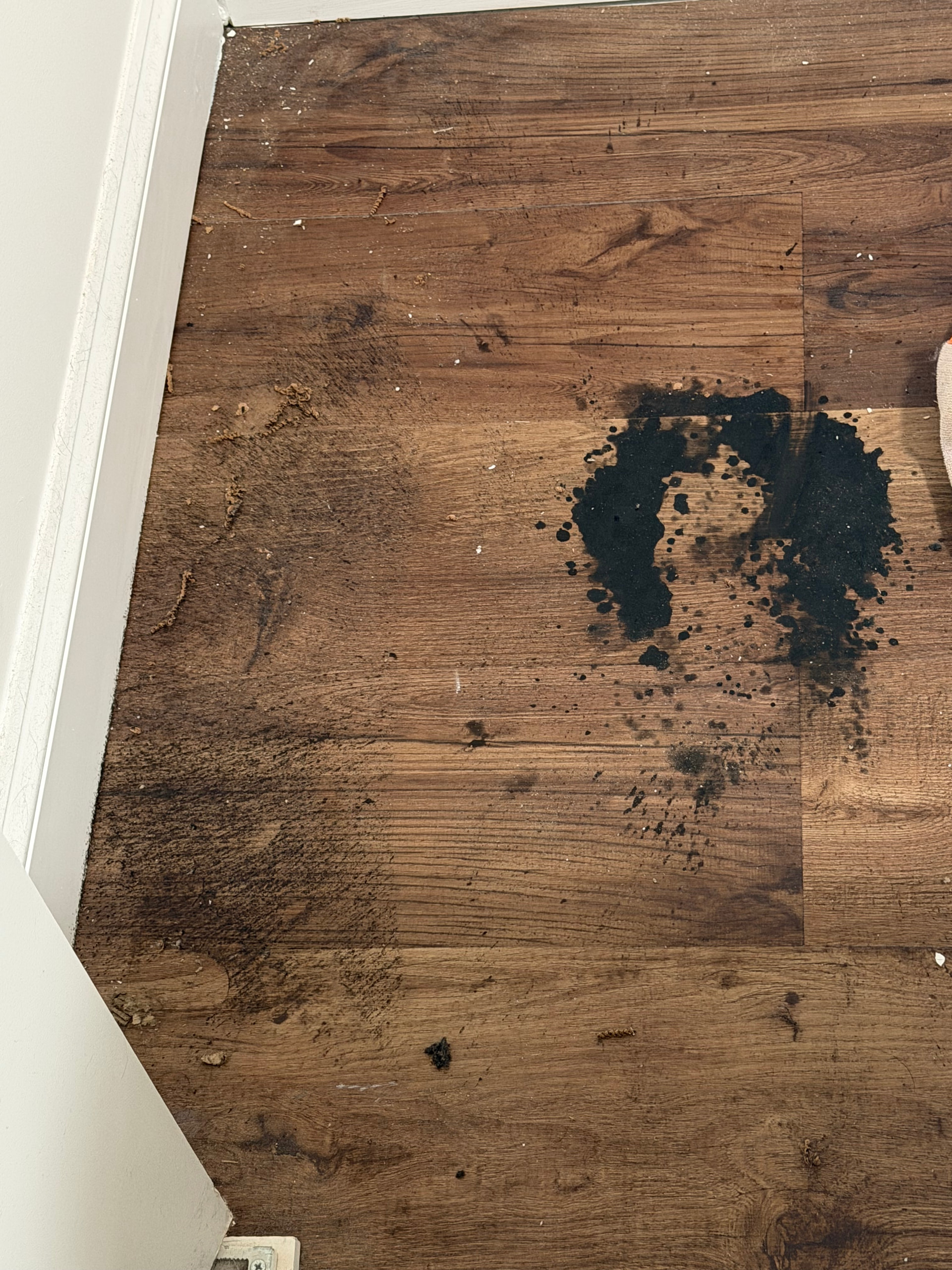

Brand: whirlpool
Model Number: WTW5000DW1
Main Symptom: leaks oil and makes 7 loud clicking noise
What happens & when: When changing cycles it makes 7 loud clicking noise. Thought it may be shift actuator, when moving the washer I noticed lil on the floor and some grease
With oil leaking, it will be the gearcase that needs to be replaced. You may consider the belt, splutch kit as well, since there is oil all over that as well. W11454734 Washer Transmission Gearcase | Genuine Whirlpool OEM In Stock
Typical Whirlpool throwaway washer when that happens!
