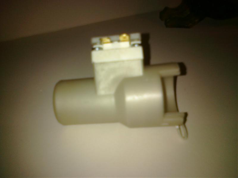

Can anyone identify this part? This is the valve that attaches the drain hose to the drain pump…but I can’t find it listed on any parts manuals. The part inventory for the Whirlpool GU2500XTPS3 has the drain hose and pump, but not this connector module.
Does anyone know what it’s called or the part #, or where I can get this part? It has a pressure sensor at the top, and FSP on the sensor.
Thanks!!
That looks like the soil sensor or pressure switch. For your particular model, the part number is AP3182693. The part is made by whirlpool. According to the parts list, it is going to run about $52.
Thanks! That was it - got a new one and everything works fine except now the drain seems to make a strong rattling noise when activated. Any clue what that might be?
