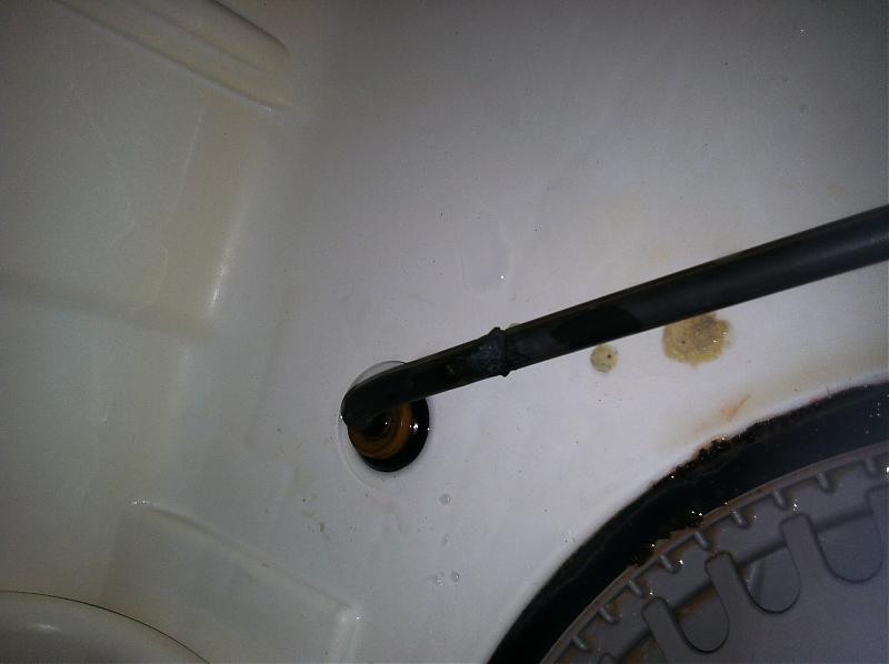

How do you tell if your heating element is bad. I have inspected it and found a burn mark. Would that be the golden sign?
photo (43).jpg (27.7 KB)
Hello Boris,
Most likely it’s bad but the best way to confirm it is to check it with an ohmmeter for continuity.
- The heating element AP5690151

Gene,
Thank you, I ordered the part.
Boris
