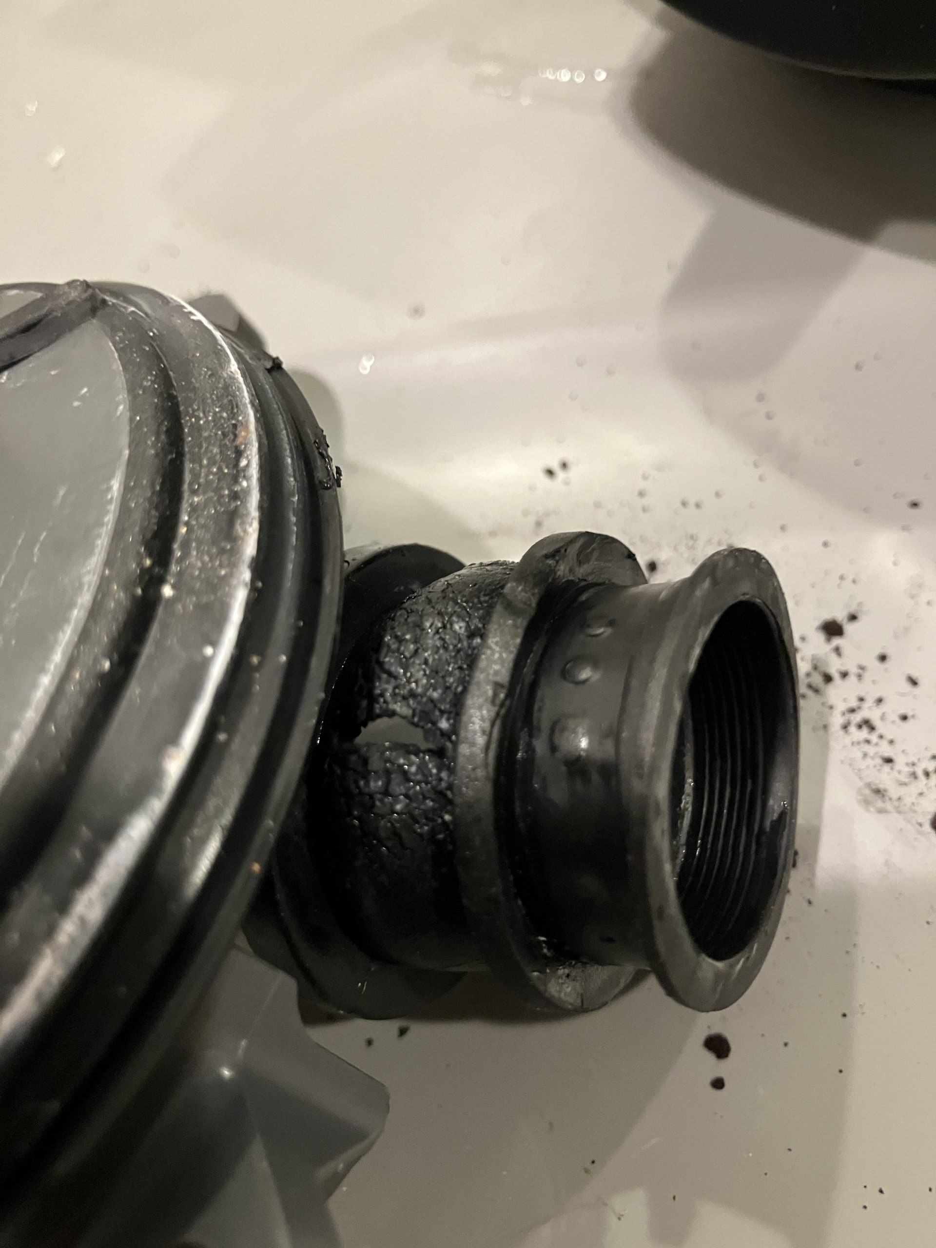

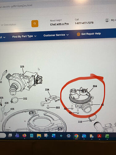

What happens & when: Last week the dishwasher leaked from the sump pump which I removed and saw there was a tear in the rubber tub where the orang float is. I ordered a new sump pum part # 504 and I installed it. It doesn’t leak now but it also doesn’t run correctly, it sounds like water is not coming into the dishwasher. The dishwasher has power and it just sounds like it is straining and trying to run.

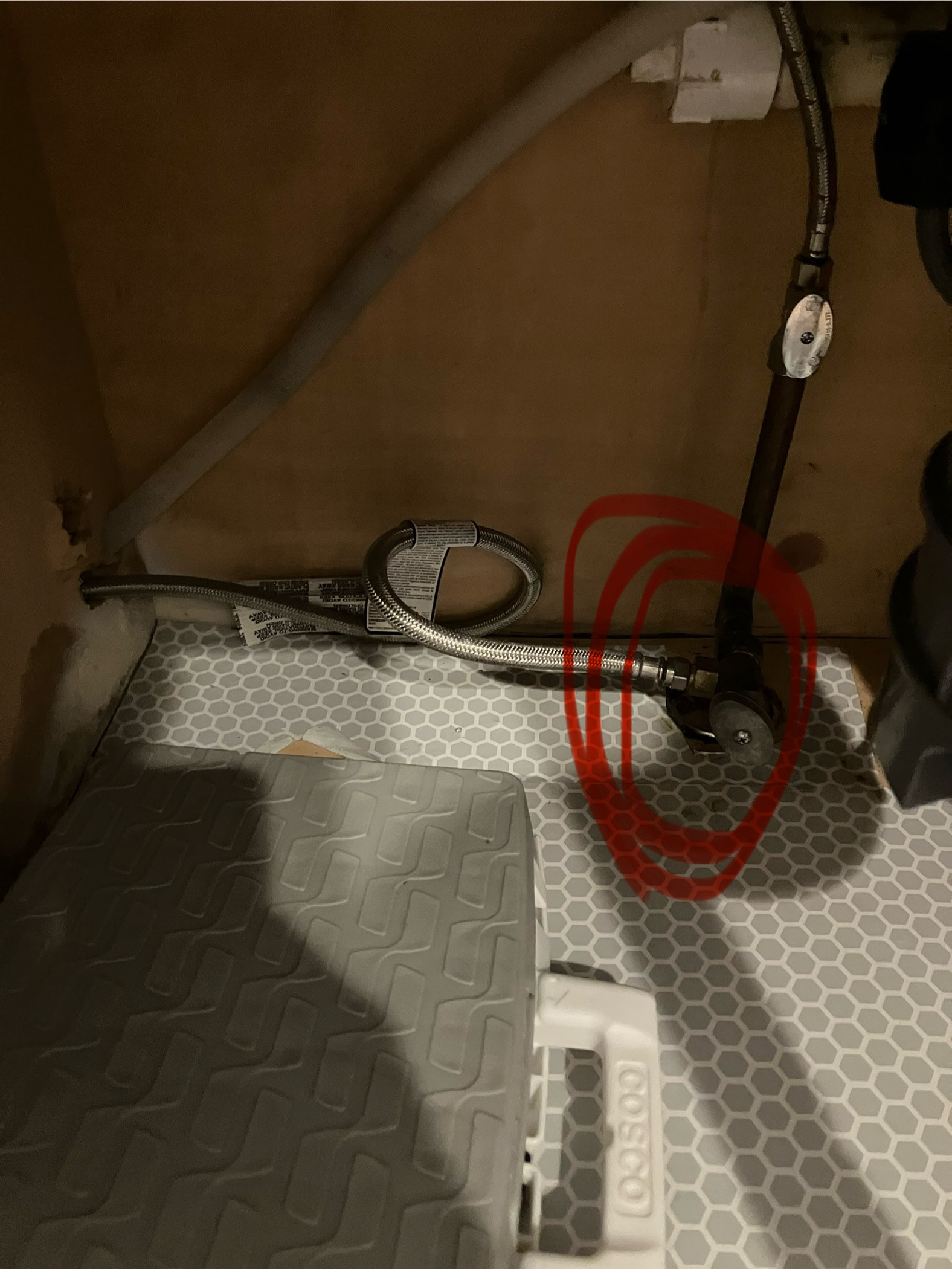

Originally, I had turned off the water valve under the sink and at first I forgot to turn it back on after I re-attached the new part 504. I eventually remembered to opened the water valve under the sink (photo attached, circled) but the same problem occurs.
Also, There was water sitting in the dishwasher while I was turning it over, and the water would come out and drain on the kitchen floor.

    • Make sure the shutoff valve under the sink is fully open.
    • If possible, disconnect the dishwasher supply line from the inlet valve (turn the water off first) and briefly crack the valve open into a bucket. You should get a strong stream of water. This verifies the plumbing isn’t blocked.
