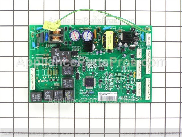

The only other thing I can think of would be that the quick thaw heater is being operated. If the quick thaw setting is not selected, the heater should not be on. It can be tested using the wires located on the right side of the quick chill fan assembly by removing the right cover plate. There will be a two-wire connector with an orange wire and a purple wire. With the heater wires disconnected, is there 120 Volts AC when testing from the orange wire to the purple wire? If there is, it is likely the main control has a stuck relay for the quick thaw heater.
