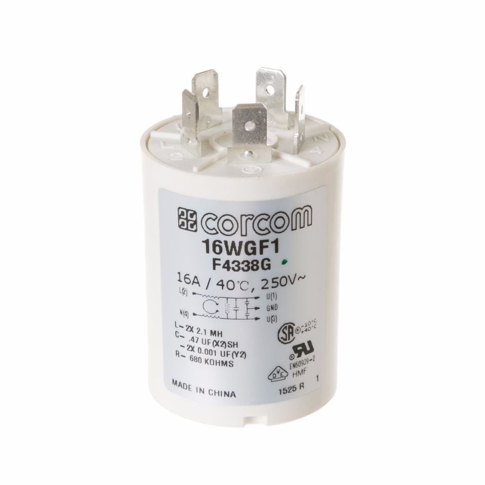

OK, I know, it’s been awhile, but I needed to find, purchase and fix a Radio Shack (clamshell) multimeter (I had one in my younger days. Nostaligic attachment, but to continue:)
The “down time” involved allowed me to review several “how to” videos, which led me to believe that checking the capacitor took/takes precedence over all the other elements.
The “lid switch” is confusing. There’s an electrical hum when set to either wash or spin, regardless of lid being open or shut. Normally, lifting the lid during any cycle would almost instantly stop the basket.
At any rate, I got the capacitor label data: It shows:
CORCOM | 16WGF1 | F4338G (photo from net file, has a different number in the lower right corner:)
As you may notice, there are 5 tabs on the bottom. Keeping the one simply marked “+” at the “6 o’clock” position (towards me) and labeling it as terminal A, the following are in CLOCKWISE order, starting around 7 o’clock:
A=+ (@ 6 o’clock, then)
B=L2
C=U1
D=3U (or U3)
E=N4
The label has a cryptic (electronics) diagram (which is above my skill level.)
Data includes:
R-680 KHOMS
L-2X 2.1 MH
C-.47 UF (X2) SH
(and) -2X 0.001 UF (Y2)
R-680 KHOMS
This capacitor is way more complicated than the 2 and 4 prong units I’ve seen so far in the “how to” videos, so I used the “round robin” method of testing Ohms (Ω) with red lead (+) to green lead (-) such as: A to B, A to C, A to D, A to E, then B to C, B to D, B to E, then C to D, C to E, then D to E.
What I got was zeros except for:
B to D = 670 mΩ,
B to E = 670 mΩ,
C to D = 670 mΩ,
C to E = 670 mΩ,
Now I’m no (current) genius, but I do realize that 670 ≠ 680, but is that a large enough gap to merit ordering a replacement part?
Update: I ordered a (new) (?) replacement capacitor, same model. (CORCOM | 16WGF1 | F4338G) but when I got it, the ohms tested out identically.
I went ahead and rebuilt the unit using the new capacitor (lightly, as I could button it up tighter if it was successful) just in case there may have been some other issue with the original capacitor, and the same result occurred: The unit “hummed” lightly in the spin cycle, but no spin. (A few retests to make sure, no go.)
