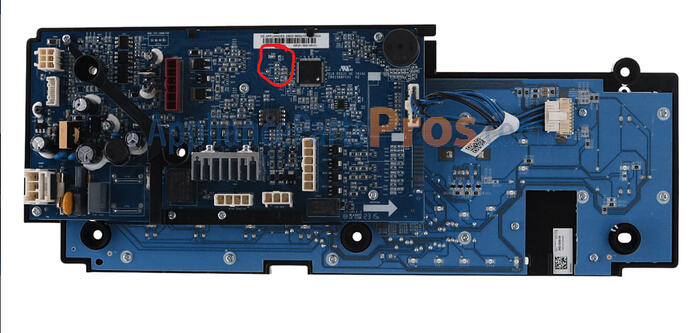

I do not see any other low voltage component that might interfere with programming. If you have the back panel of the console removed, is there an LED flashing on the control when the power cord is plugged in? This picture shows where the LED should be.
Yes there was a light flashing on the board.
This identifies that there should be correct voltage reaching the control. If you set the field service mode, will it allow you to change the test modes? If it will, are you able to enter into the fault code display mode to see if any LED light patterns show? If it does, what pattern is showing and if you turn the cycle knob clockwise, does another pattern show up? This is to see if the control is seeing something that we are not.
