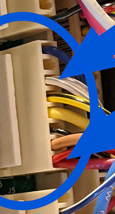

Physical Check: Dispenser door harness and connector look good.

Parts or tests already tried: Harness at dispenser door looks good.

In today’s appliances we are using fan motors and other loads made to work using D/C Voltage. This creates a phenomena known as loading down.This can make the appliance to shut down completely or affect other D/C loads.This also can cause erratic behaviors of other D/C loads. Try unplugging D/C one at a time on the main board.Like on the J2 connector that operates some of those components.

Unplug refrigerator remove J2 connector Power back up and see if the lights dimming goes away. Also see if that fixes the water dispenser. Unplugging J2 this removes a lot of D/C fan motors out of the equation.if that does not work go to J3 then J4.shut power off each time and reinstall each connector after each separate test. Look at light’s and dispenser after test and see if any of that gives your light’s on full power or dispenser works again.

In my thread titled “Is the Interface Dispenser Assembly (WR55X11092) critical for a GE Profile Refrigerator?, you asked about the top-left dispenser door switch and connector.
Well, earlier this evening, I unplugged the refrigerator, then I unplugged the bottom-left dispenser door connector and the top-left dispenser door connector.
5 minutes later, I plugged in the two connectors and the refrigerator.
For 3-4 seconds, the display flashed a series of “racing” zeros, then stopped.
The refrigerator started running and sounded like it used to sound.
However, the current symptoms remained unchanged.
BigBuck1,
In my other thread “Is the Interface Dispenser Assembly (WR55X11092) critical for a GE Profile Refrigerator? ”, you posted…
I inspected the upper and lower hinge connectors on the dispenser door.
When you asked, “I guess you look under the left fresh food door hinge on the top of the door as there maybe a connection there,” what specific action did you want me to take?
Just wanted you to make sure you saw no loose connections there!
I probably should have followed up more promptly and asked more relevant questions. Perhaps this would have resulted in more productive process and successful outcome. In the end, I had a pro tech visit my home diagnose the problem almost immediately… a bad main control board. Ordered, installed, and working perfectly. Thanks for trying!
