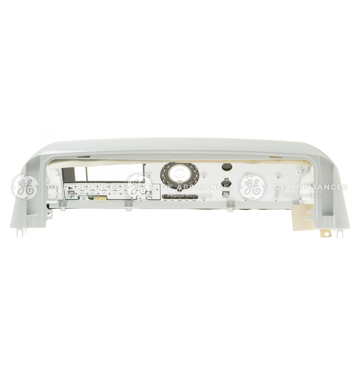

Is the touch panel part of item 13 (WH22X29062) or item 35 (WH22X31618)?
It is mounted on Item 35
How certain are you? In this photo of the actual part, item 13 “Washer Control Panel” shows the touch board and connector mounted to the back:
Those are the physical buttons but the actual control is on the main board. I suspect that the board was bad due to the display being on the board and you stating that the display would sometimes glitch. I am attaching the tech sheet which shows the wiring diagram for the control panel buttons and the control board
Tech sheet GTW335ASN0WW (1).pdf (4.1 MB)
I was able to order item 13 from you guys with next day shipping and everything is resolved. Thanks for your support and quick shipment!
