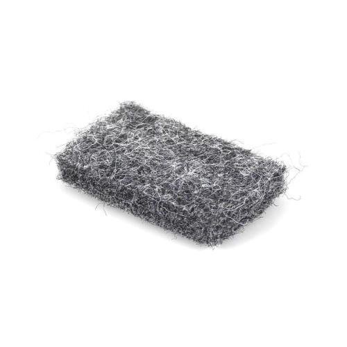

GE dryer GTD33EASK0WW very noisy
Brand: GE
Model Number: GTD33EASK0WW
Main Symptom: Very noisy
What happens & when: Very noisy when tumbling
I have followed diagnosis recommendations and inspected the front drum support. The top of the support has small, thick felt pads that are very worn and I suspect are causing the problem. The bearing slides do not appear to be worn. I want to know if just the felt pads are replaceable before ordering the whole assembly.

This is a photo of the part that is worn. I believe the part number is WE09X27635 Do you carry these?
Good afternoon,
Yes. Go to AppliancePartsPros.com and enter your part number into the search field. The description of the part will come up along with the ordering procedure. i believe that the cost, less shipping and tax, is around $8.00.
Thank you.
The manufacturer does not list the top bearing felt WE09X27635 for your model. However, it should be fine to use on the top bearing. WE09X27635 Felt Top Bearing | Genuine Ge OEM In Stock
It is so odd that there are two of these felt bearings on the drum support but they are not listed anywhere as parts for this dryer!
Newer models tend to have individual parts listed only as a part of an assembly from the manufacturer.
