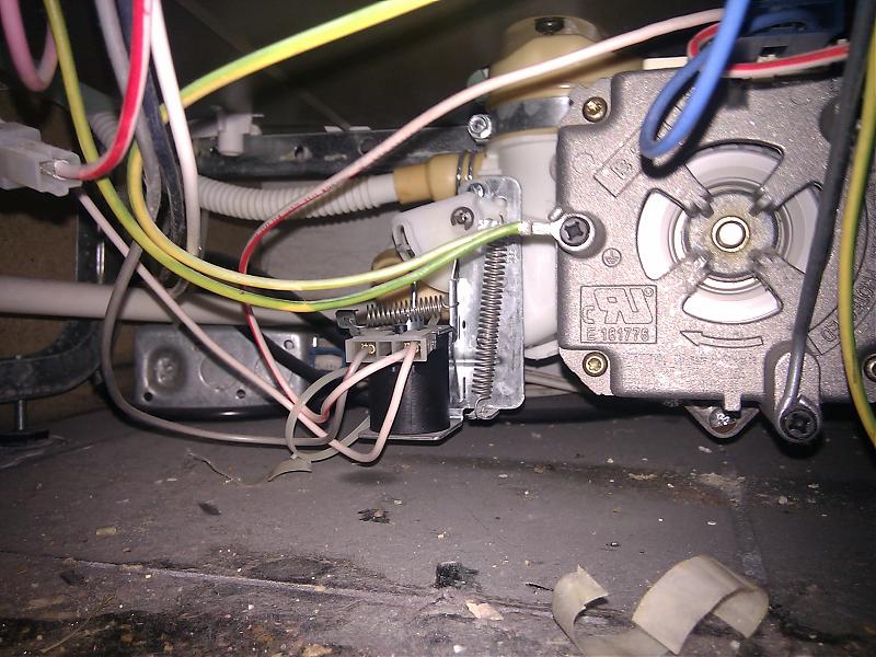

I opened it up from under. I can see the motor, a valve or relay (not sure what is the techniccal term) that pulls something which controls when it drains water. When i first start the washer. Its not draining, so its not pulling. I saw the water filing is perfect. I can see very good water flow. However what I saw is that once the drain relay is on, it doesn’t go off unless I turn washing cycle off then back on. When its filling water, its also draining and what led me to this was that I was hearing drainage when it was filling..
So to get the cycle to fill.. I turn timer to the water filling point, I turn off, on again. Filling goes OK.
Here is a picture of the relay I am talking about
[ATTACH]3471[/ATTACH]
.[ATTACH]3470[/ATTACH]
One pic its on and other is off.
Any ideas?
The solenoid will stay in the drain position (down) until the unit is empty.
The way it works is when a drain is called for the timer powers the solenoid for a few seconds. The plunger is pulled down into the drain position, this then moves the wash/drain flapper to the drain position. The water pressure then holds the flapper and plunger in the drain position until the unit is empty and then the springs pull the plunger back up into the wash position.
I would monitor the power to the solenoid. If it is powered longer that a couple seconds when it fails it is a timer problem.
If it is powered correctly, with the unit off manually actuate the solenoid to see if it is OK mechanically.
If it sticks I would remove the solenoid and check that the plunger is free.
What can happen sometimes is that the solenoid can be powered for too long, this causes it to overheat and the plastic in it melts/deforms and can cause the solenoid to stick. If this is the case then the timer and solenoid should be replaced.
