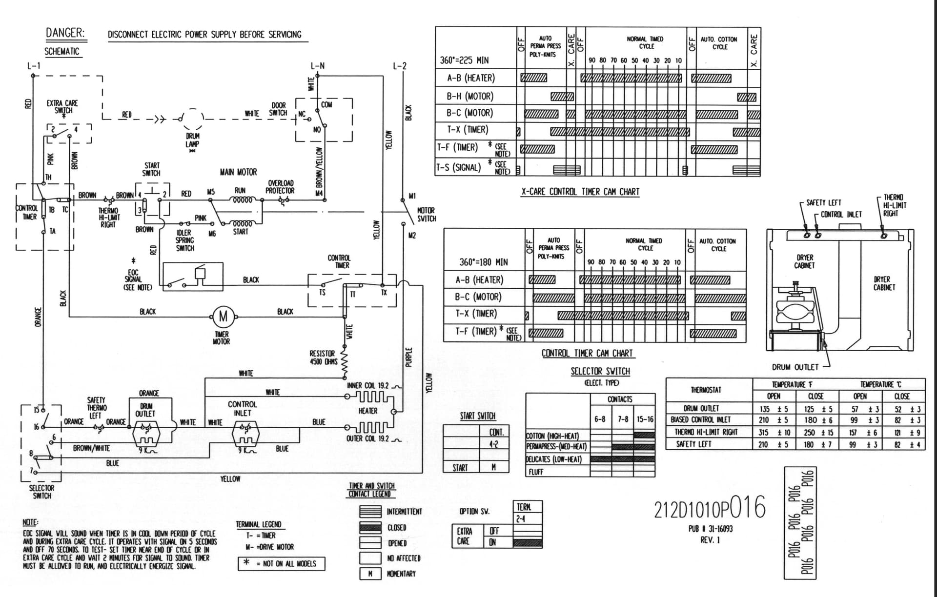

For this issue, there is a resistor that you will need to test. The resistance of this resistor should be 4500 Ohms. If the resistance is incorrect then you would need to replace it.
Also your dryer has 2 heaters.If one burns out this will also affect the auto cycle.Here is a wiring diagram of your model:
You were spot on. One of the heater coils was broken. While it is apart, is there anything else I should consider replacing? The bearing seems ok, and I think I replaced the idler pully 12 or so years ago. It appears ok. The heater kit comes with a new retainer and grounding g strap, I believe.

Althea timer resistor tests out at 4400 ohms. Is that close enough? Now you will want to check both of your heaters to make sure that they are working.
Yes, that resistance will be good for this resistor.

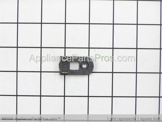

These front bearing parts are known to go bad look at them: DRYER FRONT BEARING WHITE 2PK WE03X37318
DRYER BEARING SLIDE GREEN 2PK WE03X37317
