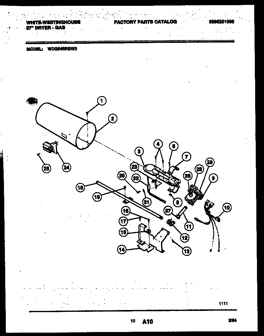

When dryer is first started cold, ignitor glows and then flame comes on. Next time there is a call for heat there is a ratchity humming sound, the ignitor glows brightly, but there is no flame. Can’t get a flame again until dryer completly cools down.
Most likely the problem is a bad gas valve coils (#28 & #29 on the diagram).
