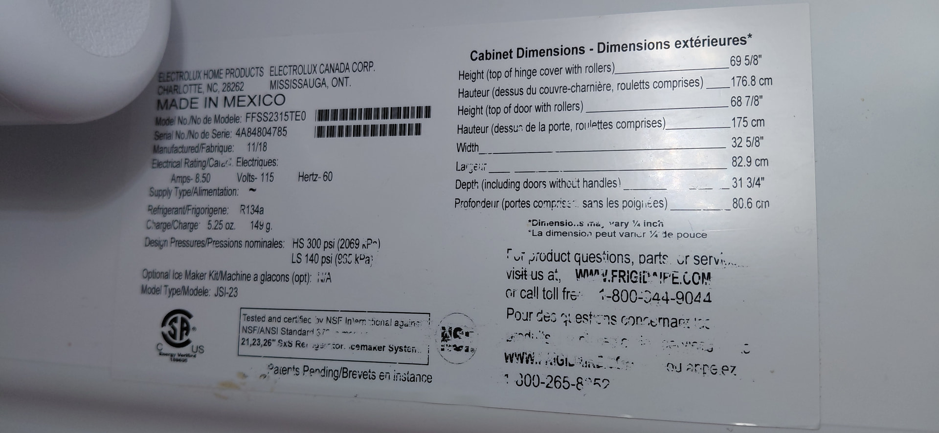

Frigidaire side-by-side FFSS2315TE0 fridge warm - freezer fine
Brand:Frigidaire
Model Number:FFSS2315TE0
Main Symptom:Fridge warm/Freezer fine
Error Code (if any): HI as fridge is over 50°
Checked the door seals.. slightly worn. Also makes a chugging noise occasionally.
