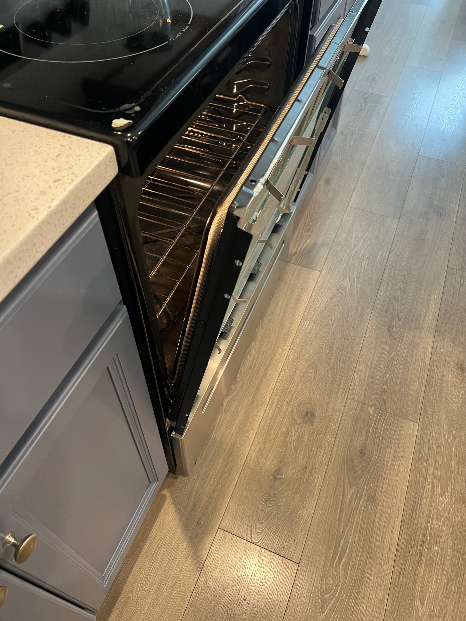

Main Symptom:Oven door won’t remain open
What happens & when: when opening oven door
Parts or tests already tried: I replaced both hinges and the oven door stays open but only slightly ajar
Make sure the door is mounted in the receiver box properly.
Also, in the picture, it looks like the door is not all there; the door without the front will be lighter, and it will not stay open due to the lack of weight.
