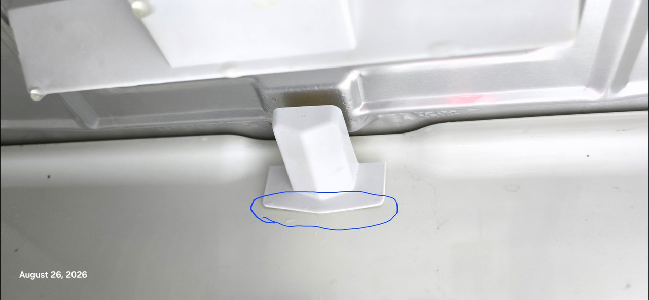

Bad news, just got home and have water in the fridge again. I looked in the back and the pan is half-full, so water is draining, but blocking somewhere. I will try to see where it comes from. I think my only other solution iss to remove the drain spout (pic 2), and see if it is somewhat clogged, however hard to understand as the pan is half full.
Hi Jeffrey. As you asked, I opened up the freezer panel and took a pic, no ice, drain hole is clear. I also removed the spout and confirmed it is not blocked, the drain hole where the spout connects is also clear and draining fine. Any other possibilities that you see that I can try?

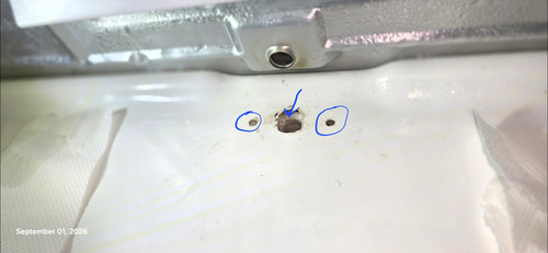

But in my opinion, the water is coming from here (blue circle), as I see it there. Don’t think there is anything that can be done?
did you ever manage to get that spout off?
Yes, it is in the picture above. I made sure the hole was clean and draining, then inserted it back in, and then I noticed a little bit of water immediately forming on the blue zone circle.
take it back out and put some RTV silicone or caulking where it mates to the fridge and reinstall. That should seal it and prevent leaks
Something like this? To put in the spout end or around the blue circle? Don’t see how to put caulking there, or what kind of caulking?
yes just however you can get the spout to seal to the fridge wall and stop the leak

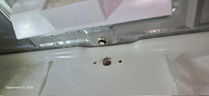

Ok thank you again. I assemble everything back today, so will see how it goes, but I have a feeling it will leak again below the spout, as per blue circle in my pic, will see.
Do you think it is possible that the water is dripping down from the freezer backwall to the styrofoam backwall, between the styrofoam and aluminum backwall (where my arrow is pointing), as it seems wet, or that is it coming out of the 2 holes (blue circles). I am not sure how those inner backwall parts are isolated back there?
