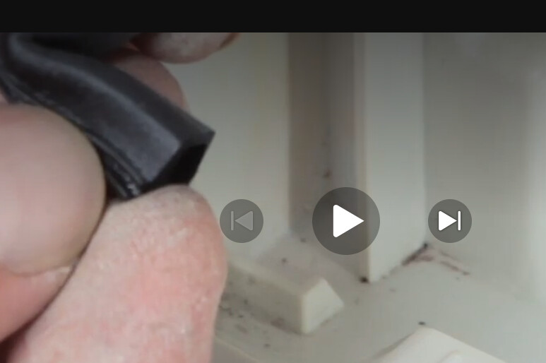

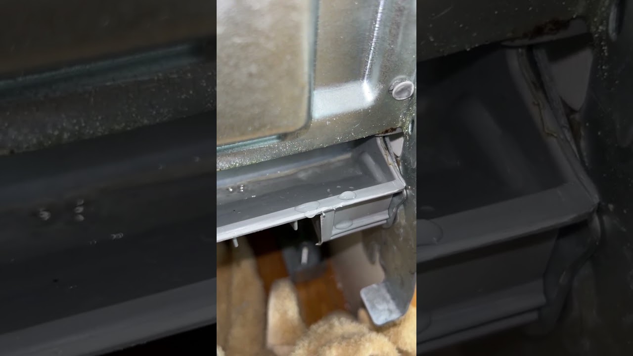

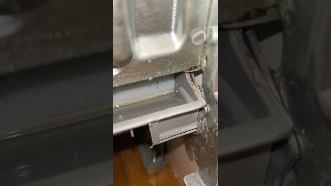

What happens & when: I believe when the sprayer shoots water the bottom door gasket cannot keep all the water in, thus it overflows in the tray area and falls to the floor. However during a load with dishes the water never overflowed. I am guessing the amount of dishes lowered the amount of water sprayed in this area. But when the Dishwasher is empty and started it will leak like in the video….
Error Code (if any): N/A
Parts or tests already tried: Frigidaire Dishwasher Tub Gasket 154827601
Photos / video link: skip to the 30 second mark of bottom video to see the biggest leak
The videos have some splash back. This was after I carefully “bent” the bottom gasket because there was a gap where it “meets” the black inner door gasket at the part where the black gasket sits like an L in the grove on either side of the dish washer.
Back story
I wanted to clean out the filter inside the dish washer so i removed the spray arm and round filter and cleaned around the drain hole. I put everything back to together an ran a cycle and 1 minute in I noticed a leak.
There looked to be water damage on the wall beside the leak, so it may of been leaking before I cleaned the filter.
I also defeated the switch so I could run the dish washer with the door open , which was a stupid idea. I had to take the top panel part off the get access to the switch to pop it back into place in order for the latch to hook.
I went and bought the U shaped door gasket, installed it but it didn’t fix the leak.
The spray arm looks to have no cracks in it.
Should I get a new Frigidaire Dishwasher Bottom Door Gasket 5304500204?

It is still leaking every now and then. i saw a white detergent stain on the left side of the floor.
Has the dishwasher level been checked and if you look at the lower spray arm, does it seem like one side sags more than the other? Final check, when the dishwasher fills with water, is it filling with more than 1” of water above the filter screen?
