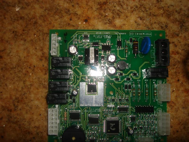

im still confused.the piced that i see there is a little different of the one i see here i wonder if it will work any ways

:confused: can i send you an email of the part of the refrigirator to show you that the part the i got doesnt look the same please anwer me . thank you …veronica…:frowning:
You can post it here by using the manage attachments button in the additional options section below your message when you post a new message.
i called couple stores and all gidme the same part number as the one i got but i wonder if the part number is just a name to call electric control i called the manufacture kitchenaid they transfer me to sears because they had the pieces for my kind of fridge and they gidme the same part number even that i didnt bought it over ther i order it at appliancespros.
At this point im just going to wait for your anwer because tere is no tech people that i can talk over the phone with you are my last hope:o .Thank you. here are the pictures of my refrigirator and the piece that i just got are this the same???

Looks to me as if you have a main refrigerator control board and the compressor’s inverter board.
The control board is in another case, I think!!!
You will see the large wiring harness going into it.
Look in the parts breakdown Item i9 in the “Unit parts” section

I just replaced the controller board to fix a similar problem. The board that you have bought is the correct board. The circuit board that you have opened in your refrigerator is the invertor board (i think it controls the compressor). The control board board is to the left of the invertor board - it is covered by a metal enclosure.
