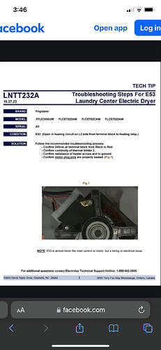

E-53 in the Tech Sheet indicates “Motor driven but sensing not congruent”. Possible causes:
  1. Motor Fault
  2. Main board Fault

This is interesting problem for sure. I would go back to basic and I personally use a multimeter with a loz setting to make sure there is proper voltage at the terminal block.Maybe L2 is not there? loading meter (also called a LoZ meter.You could do the same thing with a jumper made device like a hair dryer and a pigtail hook between L2 and neutral to see if it can run that hair dryer.this would prove that we have a good L2 that can do work and is not just ghost voltage.Hope you can make since out of this.Electrolux EFME627UTT2 Dryer Service Data Sheet A11199903.pdf (6.9 MB)
5995724217.pdf (4.7 MB)
LNTT231A Troubleshooting Steps For E53 Lux Care Electric Dryer.pdf (1.3 MB)
As this happened even on a no heat setting, the centrifugal switch sensing and the heater sensing circuits can be tested. In this diagram, the black wire at motor terminal 6 (colored in blue) is used to send a return voltage from the start winding to the control when the centrifugal switch opens the start winding circuit. Testing for voltage could be done to identify if voltage is passing through the start winding before it shuts down. At the black wire on connection J3 pin 3, there should be a voltage reading present. Along with that, if you run an air dry setting and test at the heater relay from the red wire to the yellow wire, does it show 240 Volts AC before the shut down or does it show something different? If it shows something different, what will it show if you test from the yellow wire to ground when the dryer is started in a no heat cycle? Diagram is pulled from the tech sheet for the 527 and 627 electric dryer wiring diagram.
