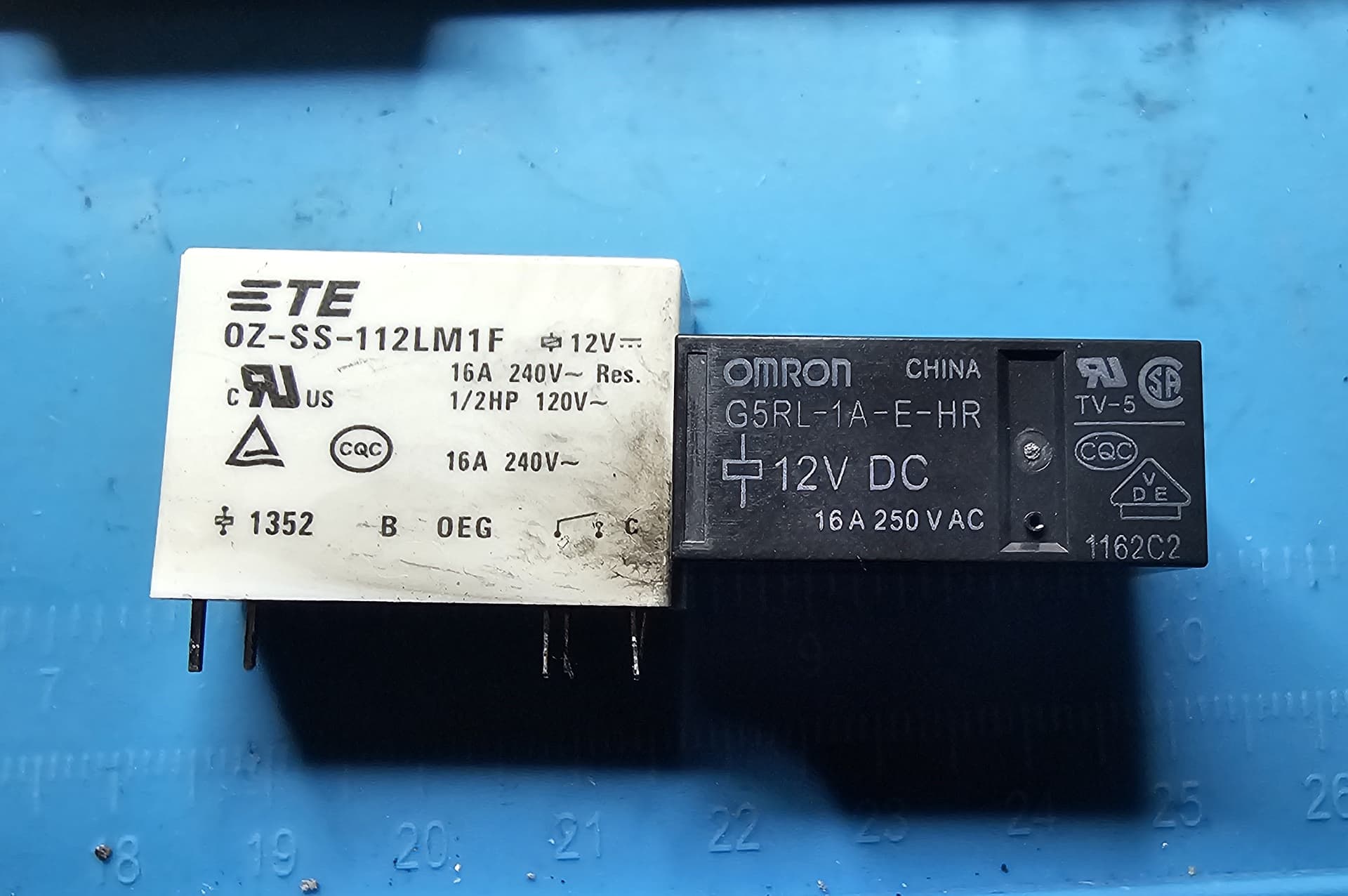

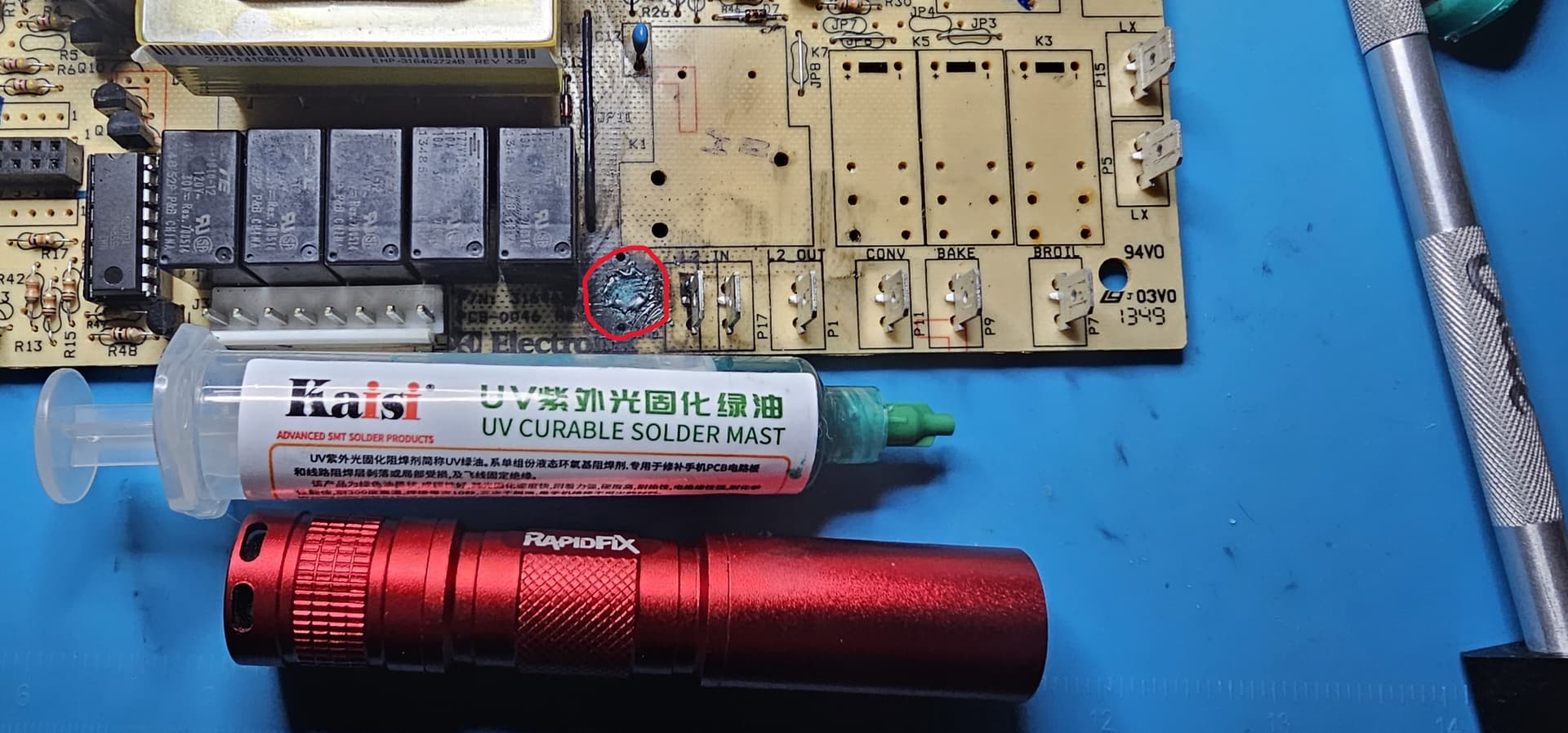

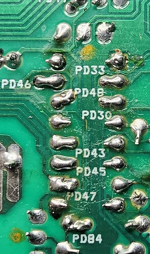

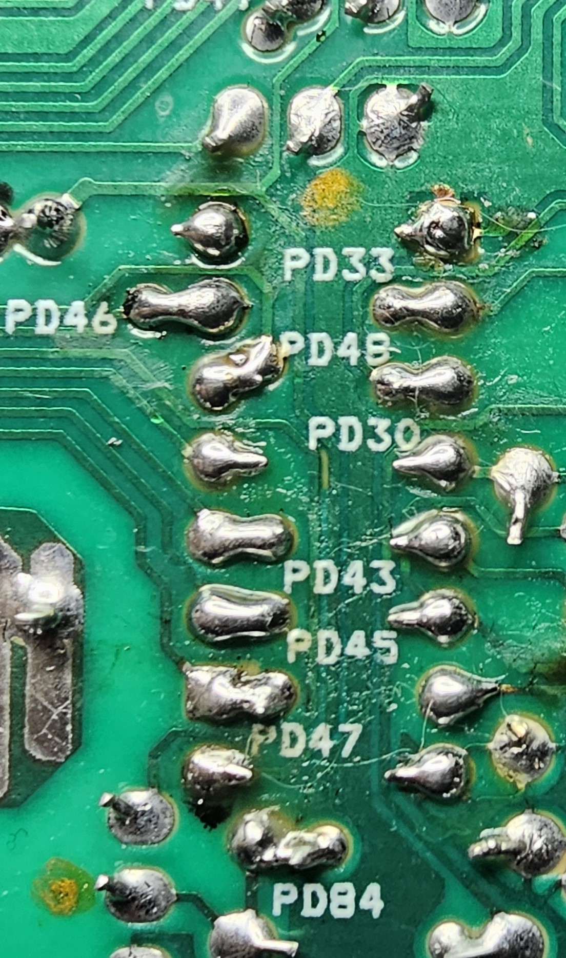

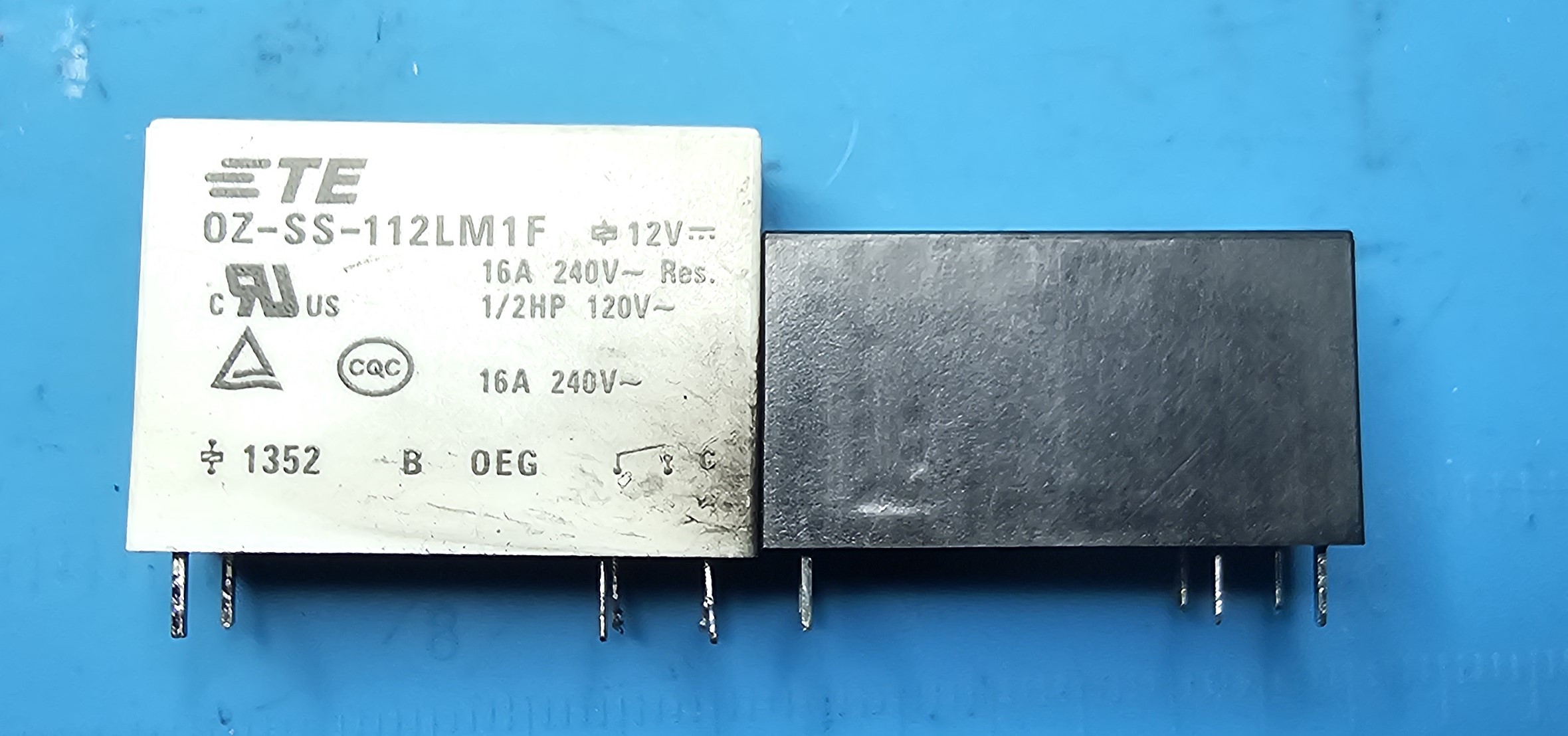

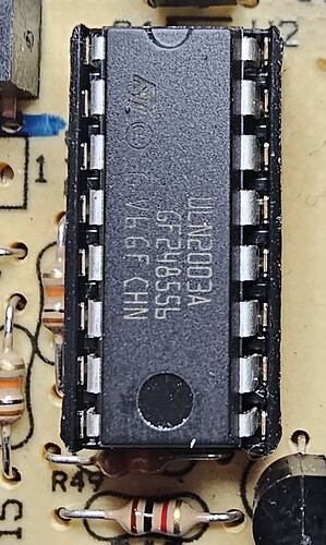

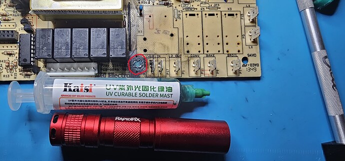

I just wanted to post a thank you to everyone who contributed to this discussion. I decided to leave a list and some pictures to help keep this alive. My stove (a Kenmore Elite Dual Fuel) is over 10 years old now, and I have been keeping it going thanks to everyone here. Today marks the 3rd fix in 1.5 years. I should have done the relays the first time when I removed them to test. On the plus side, I’m getting pretty fast at taking everything apart.
Here is a list of everything I did:
  1. Replaced R1 (220 ohms)-everytime
  2. Replaced ULN2003A ic, added a DIP socket for easier removal/testing in the future-first time; one of the channels was dead.
  3. Replaced K1 (main 240V/L2 relay)-3rd time; needed a hot air rework to get this PITA out.
  4. Replaced K3, 5 and 7 relays (broil, bake, and convection on my version of the board)-3rd time; the G5RL-1A-E-HR is an exact drop in replacement with a lower profile than the TE relays.
  5. Fixed crater left by R1 with UV soldermask.-3rd time
