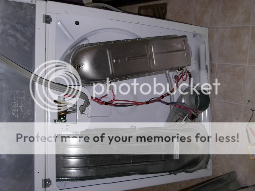

I am trying to diagnosis my prblem with my dryer while i have a few days off and before it gets colder and cant hang out clothes. We replaced the thermister and did not work, cleaned out all inner parts of dryer, as well. It runs will not heat , when in the normal load mode after about dive to ten min. AD shows up on display screen. Then it shuts off and lights underneath all blink ? Will someone please help me fix this.
Before you go any further you need to make sure that you are
getting 240 volts AC where the cord connects at the dryer.
You would “Carefully” check the outside two terminals with an
AC Voltmeter. Your dryer wont look like this one, but the way
the power cord connects to most all brands is pretty much the same.
