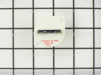

Most likely the problem with your dryer is a blown thermal fuse which is located under the rear panel. Check the thermal fuse for continuity and if it’s open, replace it. Per the manufacturer instructions, if the thermal fuse is blown, the thermistor has to be replaced too. Also check the vent for any clogs and the air flow restrictions.
[CENTER]The thermal fuse[/CENTER]

[LEFT]- The part number for the thermal fuse AP3133489 [/LEFT]

Thank Gene,
We checked the thermal fuse and the meter read zero. We are totally baffled. We checked to see if the ignitor was getting 120 v and we did not get a reading. Please Help!!!

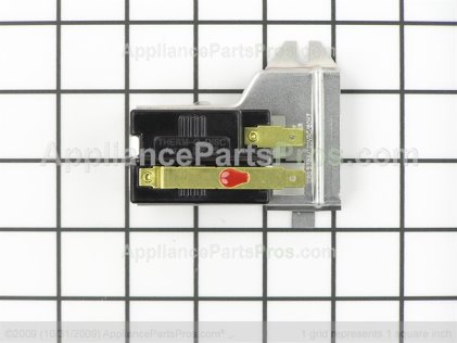

Next part you should check for continuity is the flame sensor. If it’s open - replace it.
[CENTER] [/CENTER]
[LEFT]- The part number for the flame sensor AP2910747 [/LEFT]
[LEFT]Gene.[/LEFT]
