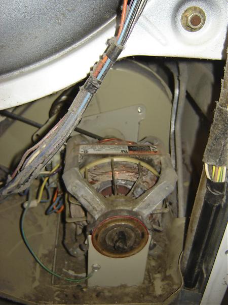

My Whirlpool dryer starts, then after a few seconds squeals very loudly, then stops.
I have attached a picture with the back off. I also uploaded a seven second video (if you can stand the noise) at YouTube - Dryer Motor. The motor part # is 3395655, model S58NXMLF-6700.
Is that the motor? Can I replace it myself (I am pretty handy)? Is there something else it could be? Thank you in advance…
Were you able to restart the dryer right after it stopped?
Remove the belt and check how the motor moves in both directions manually.

While trying to test whether the unit would restart right after it stopped, the dryer (amazingly) continued for 20 minutes before it squealed (!) and stopped. It restarted immediately. I should note that I had disconnected the gas, so there was no heat.
I am unsure how to remove the belt.

You have to do it with heat “on”
The model number should be on the dryer door frame.
I did the test with the heat on. It went five minutes, squealed and stopped. It restarted immediately.

It looks to me like the problem is the motor bearings. You can find the complete disassembly instructions in the Service manual.
Here are the break down diagrams and the parts list for the Whirlpool laundry system Model LTG6234DQ0
Will I spend more time/energy to learn how to break down the motor for the bearings than the money it costs to buy a new motor? (Thanks for the help, have I already said that? I cannot say it enough)
Thanks…but the bearings are in the motor, right?
Yes, and it is not repairable. You have to replace the motor. The part number for the motor is AP3094242.
