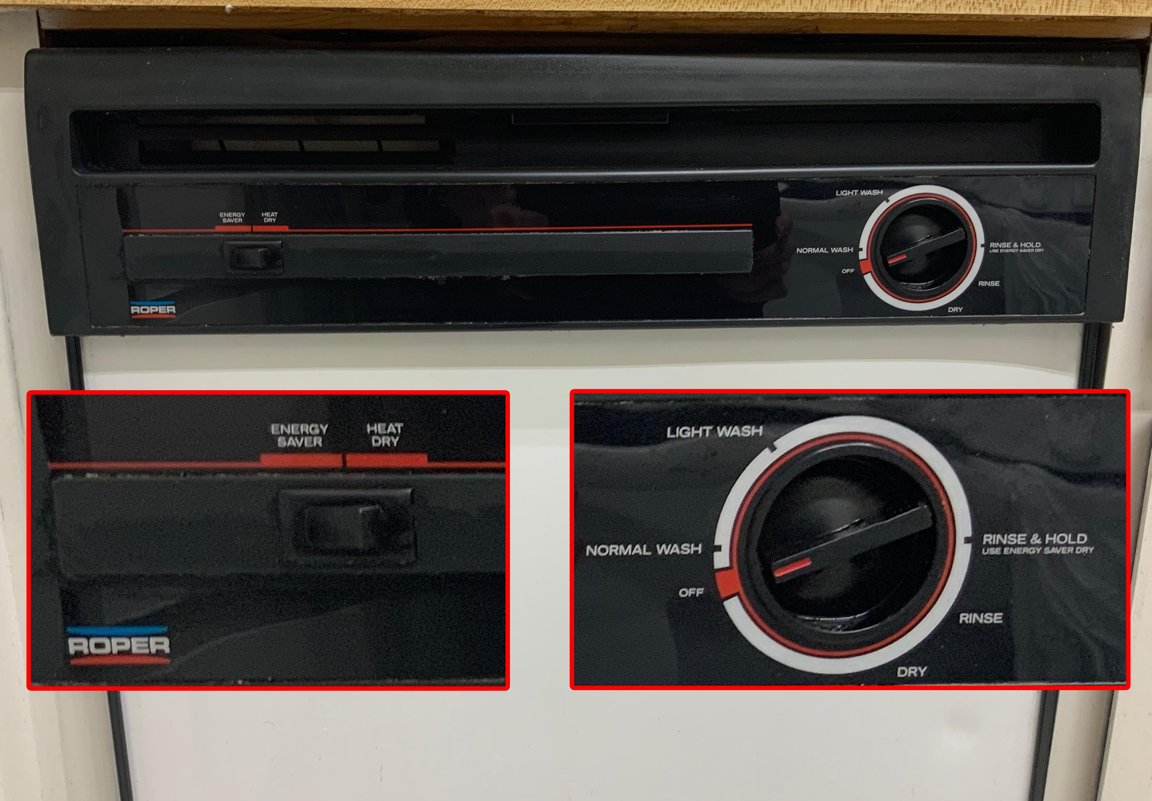

Hi Gene, thanks for your reply.
As far as the actual model number, I’m not quite certain… however, I can offer you this photo that I just took…
Mike
You can find the model number on the door frame.
WU3000X1
WU3000X1[/quote]
You may want to check the float and the float switch (#32 and #30 on the diagram).

Wouldn’t a damaged float still allow water to get into the machine? Or does the switch that the float actuates, break in the “on mode” causing the machine to believe that the float is at the top therefore it won’t take on any more water?
