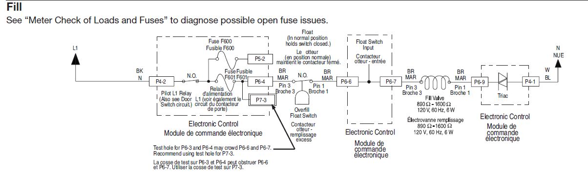

What happens & when: No water out of fill valve on startup. Panel controls all seem to work. Replaced inlet valve and no change. Error code was faulting float switch. 6-4 I think. replaced float switch with two different new switches and no dice. Later metered the removed switches and on/off continuity ok. Confirmed the float travels up and down freely and operates the switch properly. Should I try the door switch next? Note: the dishwasher was previously dead only because of no drain. I found the drain hose clogged and replaced it.

Check the fill valve for power from the board on P6-7 and P6-9.
Ref. the tech sheet.

Using the tech sheet for your model, confirm you have power into the board and then out to the wiring that goes down to the valve. Wiring and or loose connections can be an issue as well as a part.
