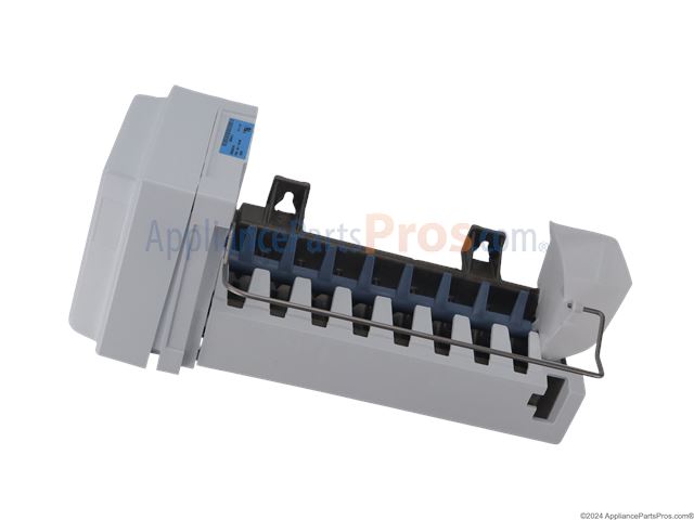

Control board troubleshooting of Whirlpool WRX735SDBM00 refrigerator ice maker; service tests #45-59 do not display. Can't troubleshoot the ice maker, as a result
Brand:Whirlpool
Model Number:WRX735SDBM00
Main Symptom:service tests do not display #45-59: ice maker
What happens & when:cannot conduct the service tests for the ice maker
This model doesn’t have those tests. The icemaker W10882923 in this one is a modular standalone.
Here’s the tech sheet for this model:
techsheet-w10525816-reva.pdf (198.1 KB)
And here’s the icemaker testing info:
modularicemakerservicesheet-2220407-reva.pdf (175.8 KB)
Your model has a bail arm instead of ice level sensors and is in the fridge instead of the freezer, but otherwise the testing info is the same. With the door switches taped down you should be getting 120v AC from L-N on the icemaker head, if you aren’t you can pull the icemaker out and check voltage from violet/purple wire to white wire where the icemaker harness connects to the harness coming out of the fridge wall. The other service tests are described in the guide.
