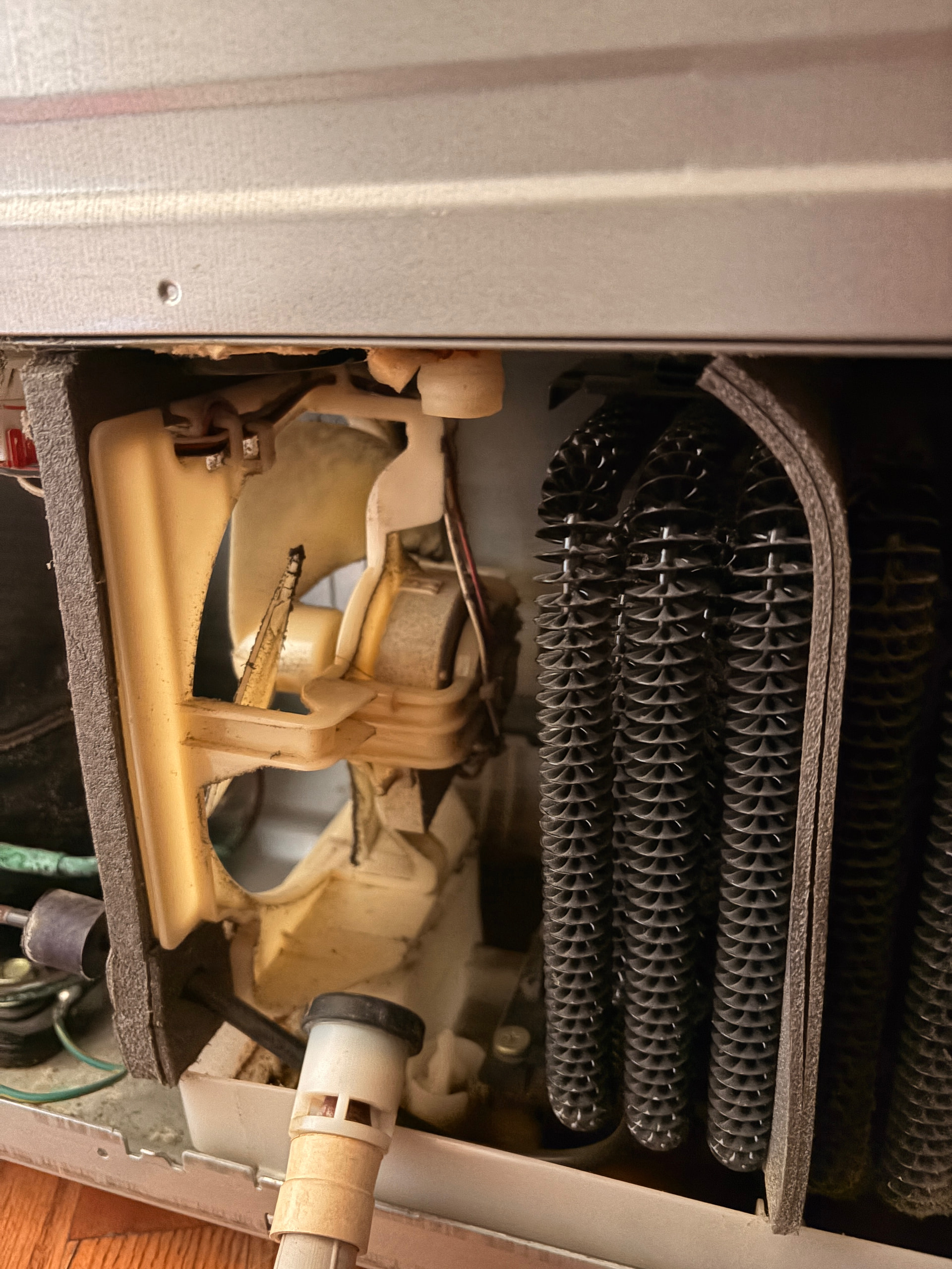

Can I do all of this from the front after taking the covers off or do I need to pull it out and inspect from the rear of the refrig/freezer, as well?

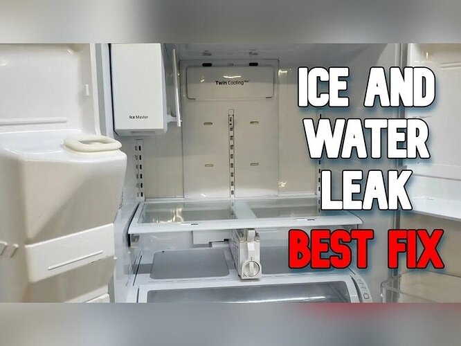

I read that Samsung made this unit for GE and found this. Would this modification apply to my unit?
You can do this from the front, but I’d recommend pulling it out so you can access the drain pan in the compressor area and clean it out once your done flushing the drain line.
GE isn’t listing a fix like that for this model so I can’t say if it would apply. They do look very similar though.

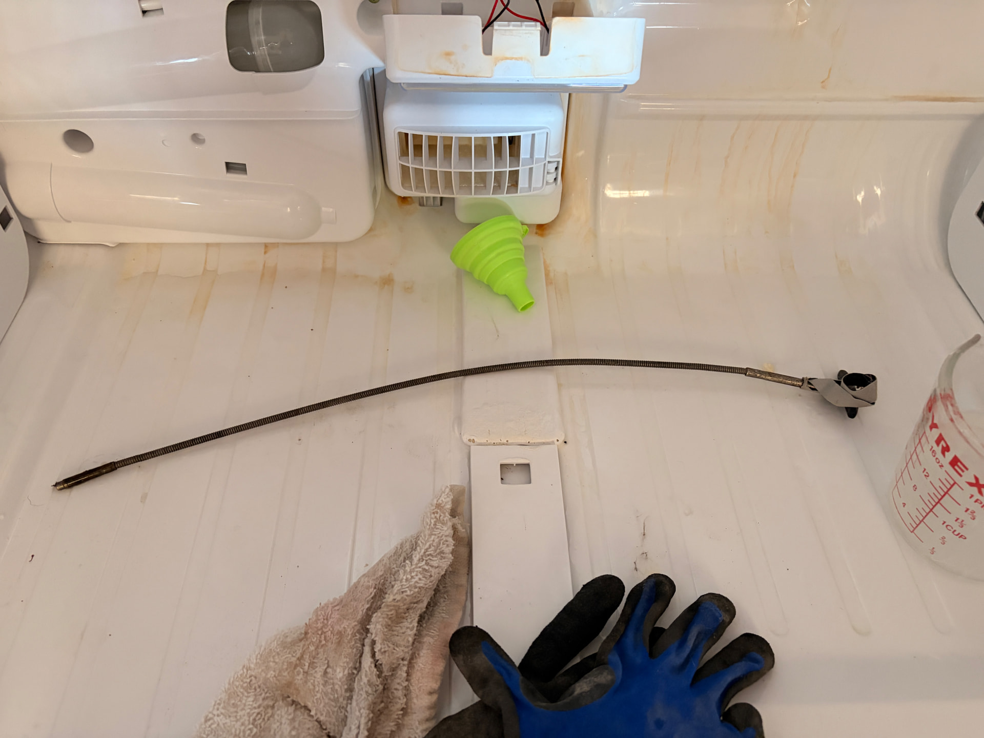

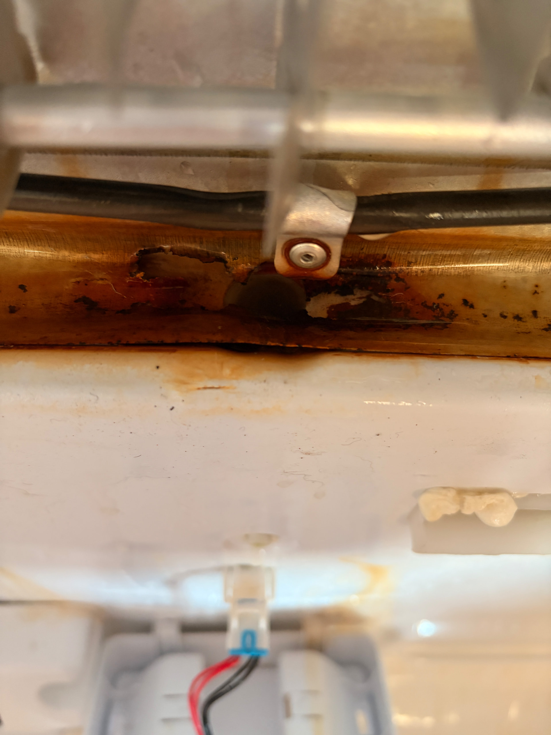

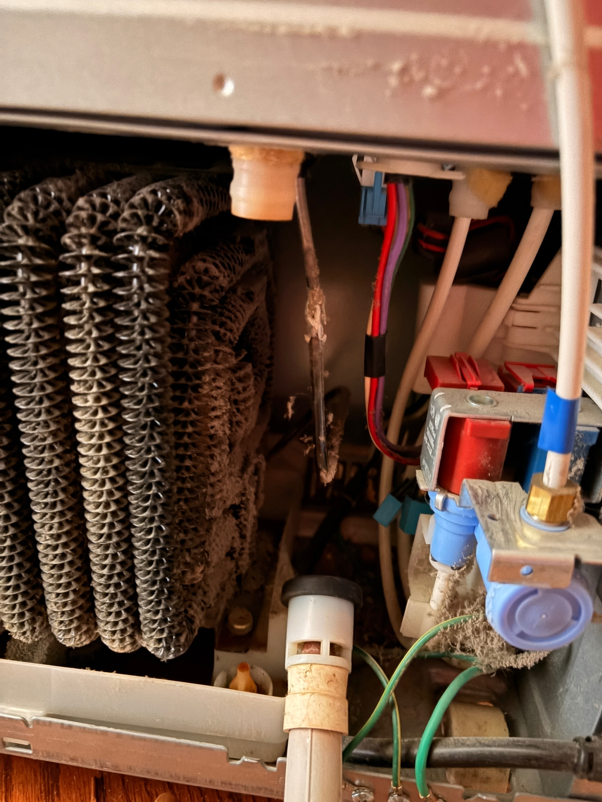

So I got the cover off and as you’ll see from the picture, the metal will call it guard pan that goes the full with has started to corrode. I have removed all of the ice and moisture in that area and I can put a screwdriver down about an inch before hitting something solid. Am I to assume that’s Ice? I also removed the back and disconnected both of the drain tubes and as I’m facing the unit, the closest to the right I can send that flexible magnetic grabber 21 inches up without any resistance. On the left side is facing which I’m assuming is going to the refrigerated unit I can only get it up about 2 1/2 inches. What is the best way other than just turning the refrigerator off to get that portion of the drain tube to melt?
That very well could be ice. Flushing it with warm water is the best way to clear the ice blockage, if you’ve got a shop vac you can pour the water in there an let it sit til it cools then vacuum it out, repeat as necessary. Use weedeater line as you go to help with breaking up the blockage. From the other end you can do the same thing with the weedeater line and maybe use a hair dryer on the lowest sitting to direct air up that drain.
Got it to defrost and drain
poured 2 cups warm water with 1 tsp baking soda and it flushed right through into the cup
All back together and fingers crossed.
There was a metal strip wrapped around heater with rivet that too was corroded. I’m thinking some of the corroded metal helped clog it up?
