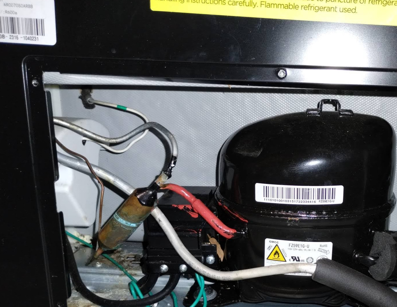

What happens & when: The freezer does not cool at all. When plugged in, the unit pulls about 600 watts for about 5 seconds. A click is heard and the wattage drops down to 0. It seems repeat the process after a bit… I don’t know if it’s 3 minutes or 8 minutes or some other length. When the unit is pulling the 600 watts, the compressor or does not vibrate, hum, or twitch.. nothing I can feel or hear. The compressor is warm but not hot to the touch.
Error Code (if any): No display or speakers for codes.
Compressor: GMCC FZ59E1G-U

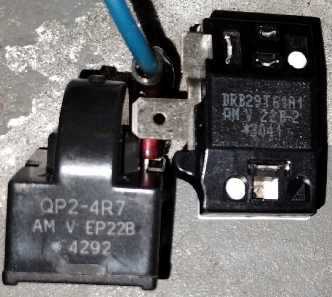

  • The PTC relay (QP2-4R7) has continuity at room temp. Does not rattle and the internal looks intact (disc not broken and no lose metal parts) with no black scotching. The PTC relay has one wire going in with two pins to the compressor.
  • The overload/thermal protector (DRB29T61A1) has continuity at room temp. This component has has one wire going in and one pin to the compressor.

[ Photo 1: Compressor with model #, PTC & Overload box to the left of the compressor. Dryer Filter. “V” shape white box on the far left is the thermostat control box (Off-min-max). ]
[ Photo 2: Inside the the black rectangular box to the left of the compressor are two components: the PTC (left) and Overload (right). ]

UPDATE 1 (6/3): Replaced the PTC and Thermal Protector. Now instead of no hum/vibration, it does hum/vibrate for the same short period (previous there was no hum/vibration) and shuts off on a click, like before.
From all the description, it sounds like the issue is the compressor, possibly locked up.
Defiantly a system issue beyond DIY. You will need an EPA certified sealed system qualified technician for this repair.
