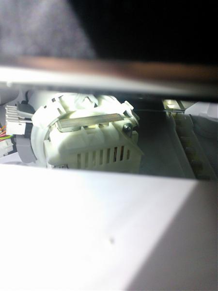

My dishwasher isn’t filling with water, just drains continously. Tried pouring in 2 gallons of water, but it just drained it out.
I’ve also sponged out all the water from the filter area, and shop vacuumed it to bone dry - still no luck.
It was working fine, but I had to take it out to install a water hammer arrestor, and now after the reinstall it immediately started acting up. I have confirmed that the water supply is getting to the washer…
Anyways I’ve tried most tips online, but I can’t find any advice for this specific model.
Any advice is appreciated.
Thanks!
Dropped both sides, and got a few pics. 1st 3 are of the right side. Last 2 are of the left side.
In the last picture, the curved tube to the left of the red knob are 1/2-3/4ths full of water.
Any ideas? The dishes are piling up! Wasn’t that great having TGiving w/no dishwasher :frowning: Hope everyone had a nice holiday.
