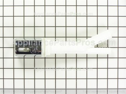

Do you have the air gap on top of the sink or the drain hose is connected straight to the garbage disposer?
Gene, thanks so much for helping me out. The air gap goes to the top of the sink. We pulled off the cap, and tried pouring some water down it, but it doesn’t drain unless we ram a long wire down there.
Are we talking about the same device?
[CENTER]The Air gap
[/CENTER]
[LEFT]Gene.[/LEFT]
Yes, we’re talking about the same device.
The hose goes from the air gap on top of the sink to somewhere at the bottom of the dishwaher.

Yesterday my husband replaced the airgap section, and the bad smell completely disappeared. I won’t go into how many other plumbing problems ensued (it was one of those days), but at least our dishwasher doesn’t smell like garbage anymore! :smiley:
