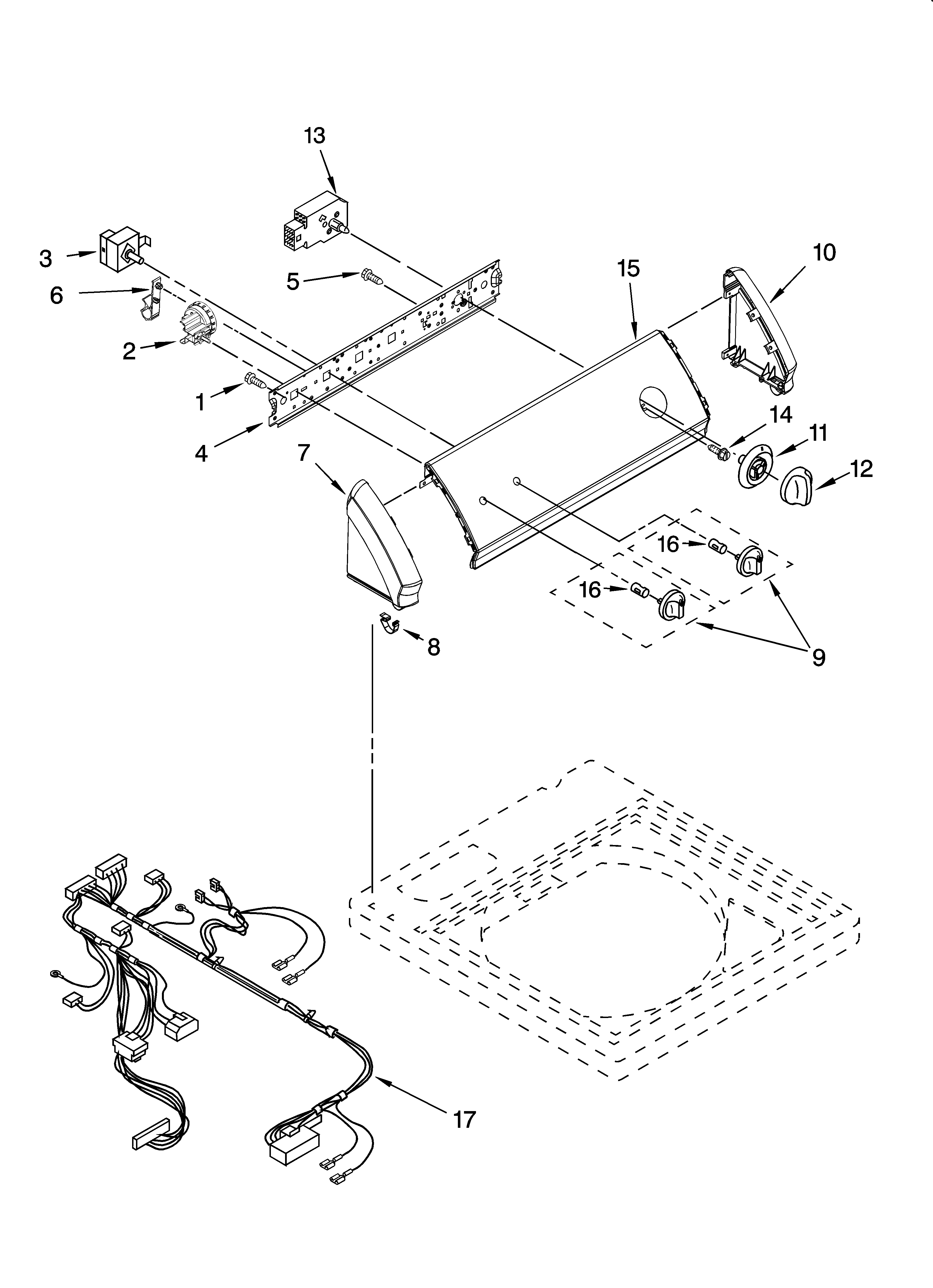

washer only spins in perma press cycle other two cycles won't drainor spin, but continues to off. somtimes if it is turned manually to one of the other cycles it will spin , but not all the time.

Check the motor for continuity between the White & Blue and between White/Black & Blue terminals. Post the results.

the console looks a little different , do the let and right plastis pieces just pry off/

Dave,
There are two clips (#8 on the diagram). Push them with a putty knife to release. Be careful not to damage the paint.

I have continuity at white & blue white/blackand blue.Whats next,

Dave,
Sounds like the problem is a bad timer.
- The timer Part number: AP3951308
