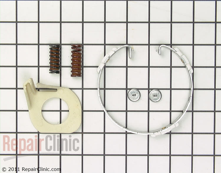

1: The Clutch Band
http://www.rcappliancepartsimages.co...3/00555268.jpg

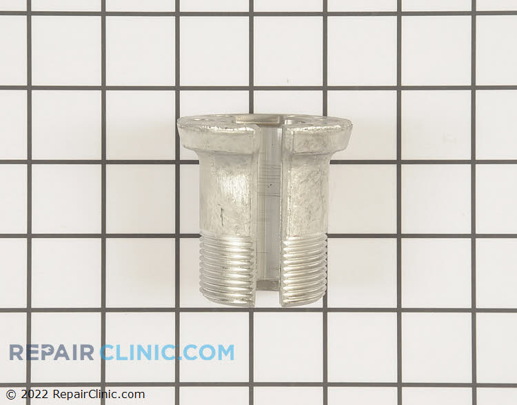

2: Drive Block
http://www.rcappliancepartsimages.co...5/00928580.jpg

Sounds like the drive coupler between motor and transmission is shot. The clutch and drive block have nothing to do with agitation.
