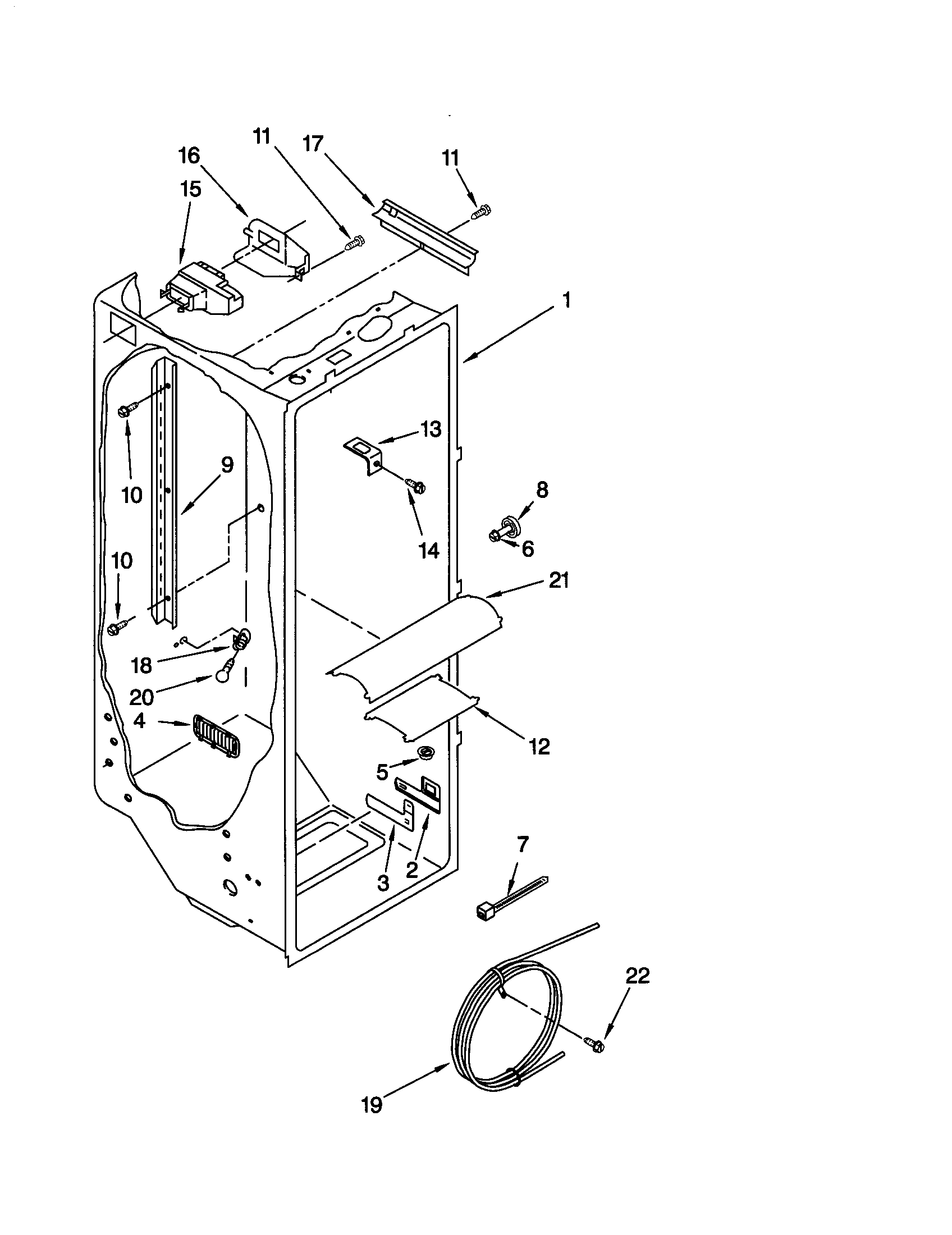

Originally Posted by vinh_golf View Post
I have side by side Samsung fridge bought 3 years ago, model number RS253BASB. The freezer is fine, but the fridge side is warm. At the beginning, I control the temp. of the freezer side, but not the freezer side. I unplugged the power and plugged it back. Now the temperature panel is flashing for both 2 sides, indicating temperature of 88 and I can not set the temp. either. Moreover, one morning about 1 week ago, I heard a somewhat loud noise from the fan, probably for about 30 minutes. This problem -the freezer side is cold, but the fridge side is warm - has been going on for about 1 month. What is the problem? Is this the defrost heater trouble or the control panel problem?
please help.
Thanks.
Hopefully the attached troubleshooting instructions will help.
Here are the breakdown diagrams and Replacement parts for MAYTAG RS253BASB | AppliancePartsPros.com

On my fridge, the louver is fixed. It can't be open/closed.
Charles
Quote:
Originally Posted by Gene View Post
Hi Charles,
Sorry for the delay. Have you checked the louver (#4 on the diagram)? It must be completely open to provide air return.
Reply With Quote

It looks to me like it is a simple bar and air should go through unles it's frozen or blocked somehow else.
Gene,
The lower right of the fridge side is flashing and according to the diagram, it's state that
Refrigerator Defrost Sensor measures open or shorted.
What should I do next.
Thank you.
Gene,
Thank you.
Vin
Vin,
Probably you have to replace that sensor.

I don't understand what you mean by "simple bar".
I've pulled the louver off, I don't see any blockages; however, the airflow isn't a straight path. It appears to flow down (inside the divider) and must then flow to the back where the coil is as the opeing in the freezer side is back by the coil.
I don't have any clue how I could check the whole path.
I suppose I could turn off the fridge for a few days with the hopes that if there's ice blocking the path it would melt. However, even if it melted would it drain out so it wouldn't freeze again?
Thanks!
