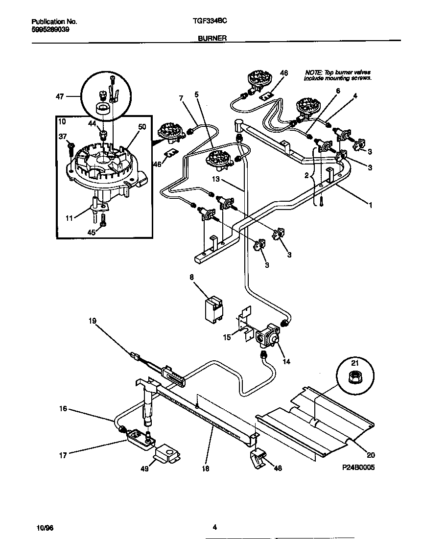

Burners work, glow plugs work--oven does not light. Found model # tgf334bcde.

Most likely the problem is a bad oven igniter (#19 on the diagram).
You have to remove the oven floor and the flame spreader to access the igniter.
- The oven igniter Part number: AP2150412
